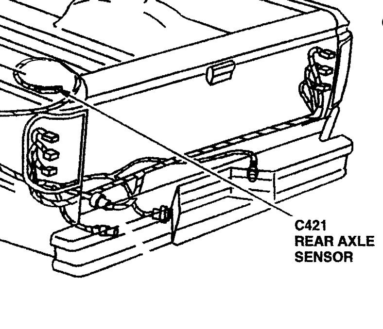

Recently my speedometer stopped functioning properly. First it would only come up after I passed 30 mph or so, then the other day it stopped working all together. The truck seems to still shift fine, what should I be looking for?
Jul 17, 2009 at 2:39 PM
  • 55,658 POSTS
It sounds like you have a vehicle speed sensor that is going out and it needs to be replaced.
You will need to jack the car up first
Here is a diagram of the sensors location so you can get the problem fixed.

This happened to me on a 99' Ranger. Ended up being the speed sensor in the rear end was bad, simply replaced it, and it worked perfectly. I didn't get the lights on the dash, but I didn't have overdrive. Mine was a standard also.
