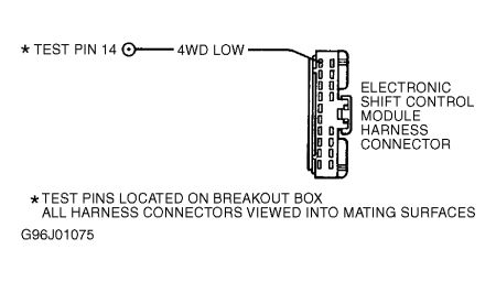

Ok this is pointing to the PCM as the problem. Before changing it I need you to inspect the wiring from the gem to the switch and check for any breaks or ? Unplug the gem and check for corrosion. If that all looks good then use the pic below and unplug the gem and the switch and check the resistance at term 14. Gem plug
https://images.2carpros.com/forum/automotive_pictures/249564_Graphic_208.jpg
Switch
https://images.2carpros.com/forum/automotive_pictures/249564_Graphic1_34.jpg

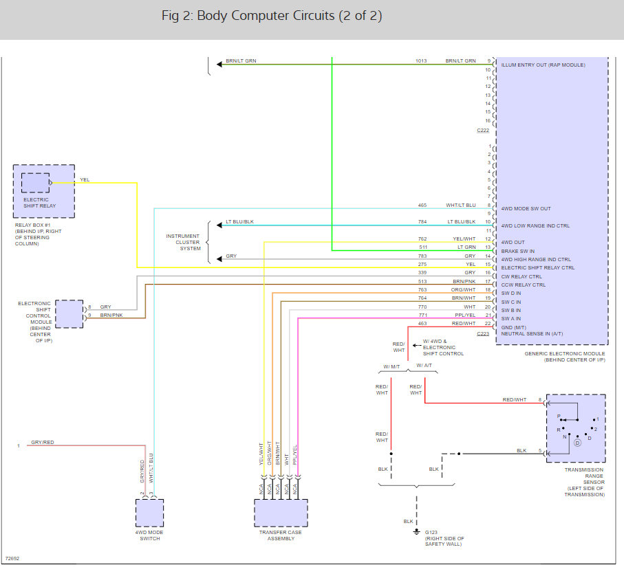

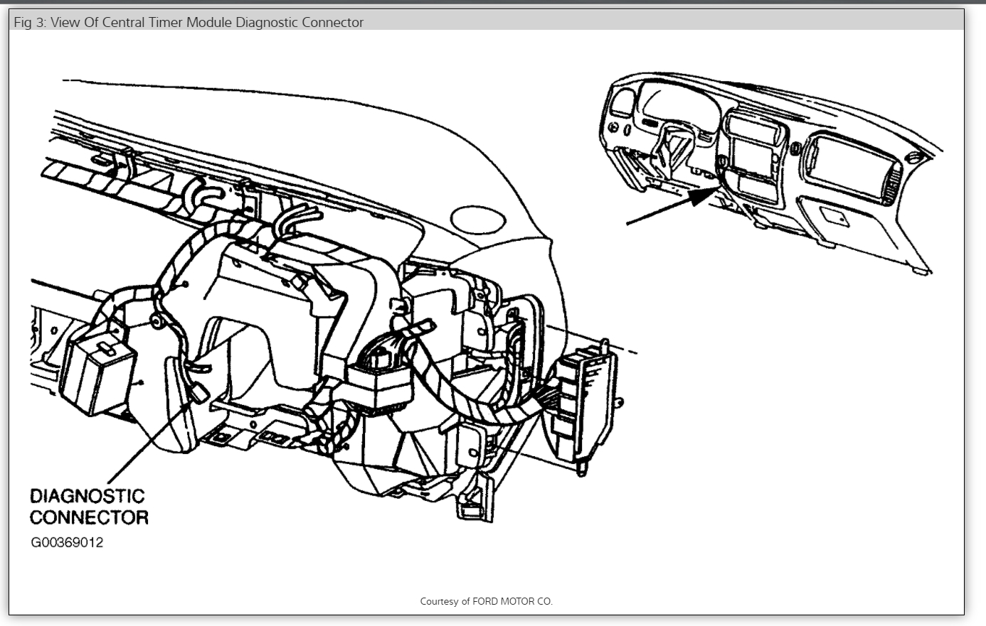

  • 55,423 POSTS

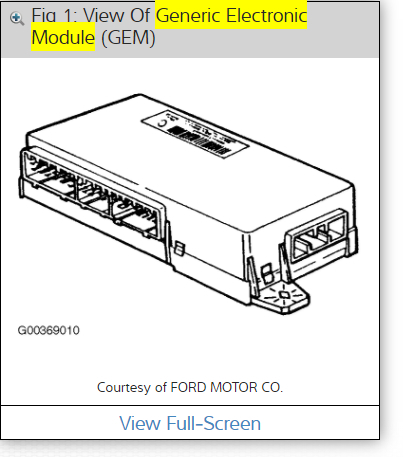

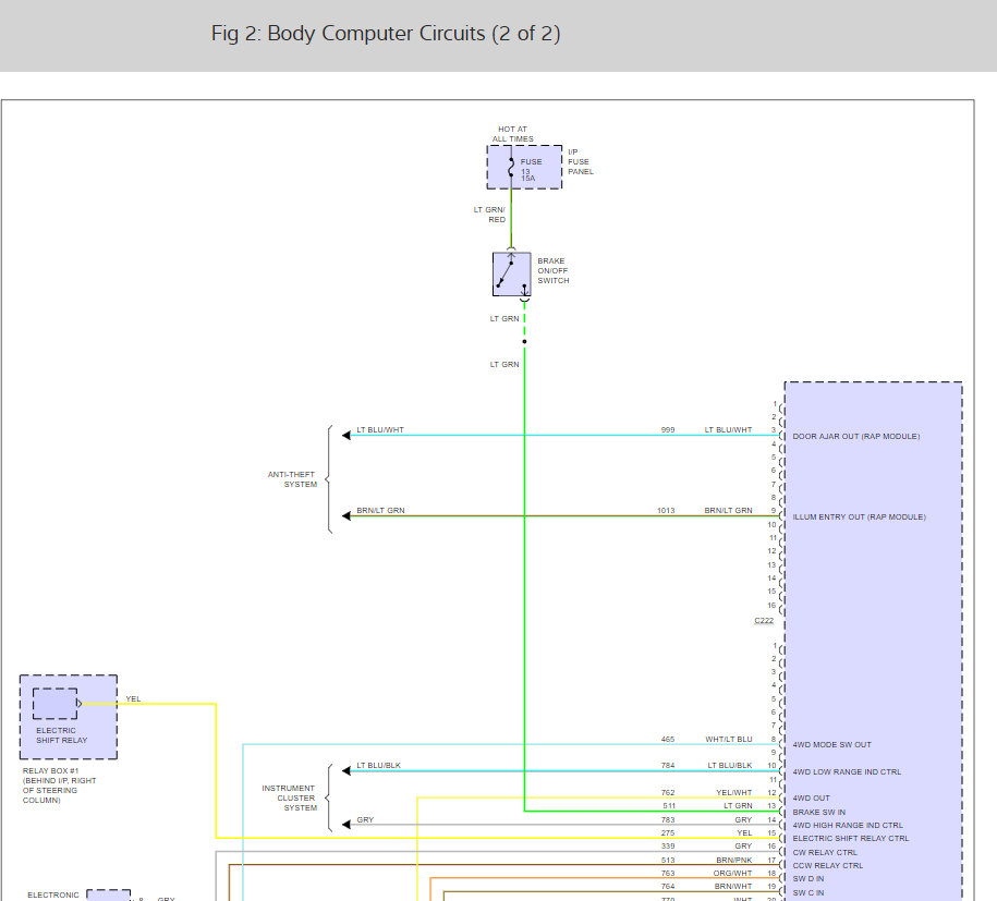

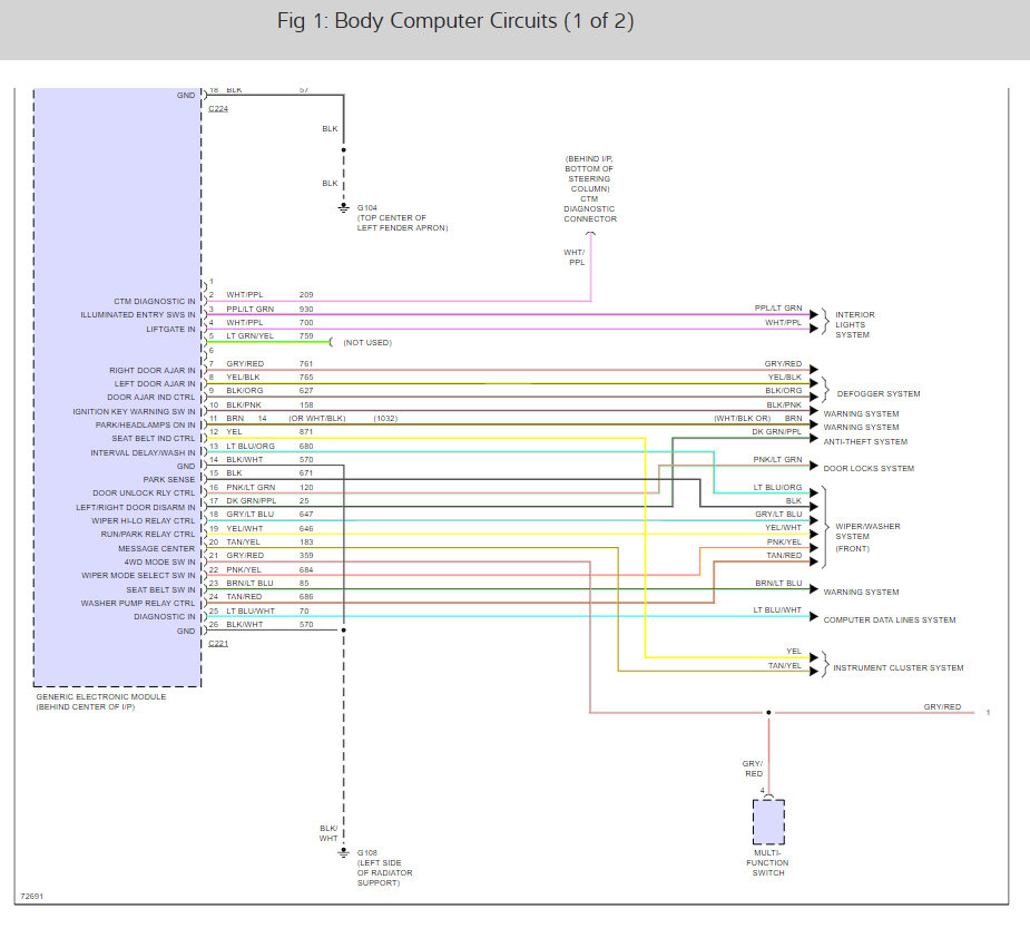

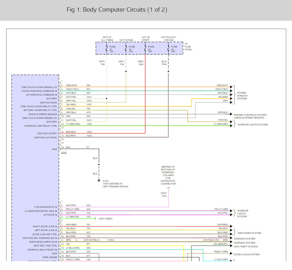

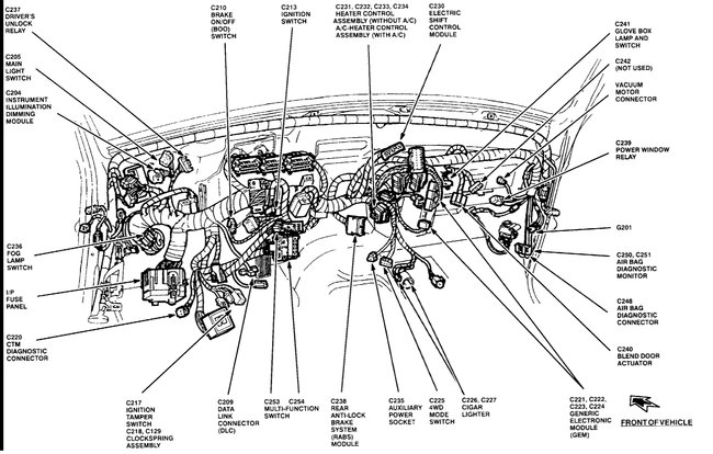

The GEM (generic electronic module) is basically a body control module. It controls things like interior lights, power windows, etc. It is located in the center of the dash here are some GEM wiring diagrams so you can see what it attracted and its location as well (below)
