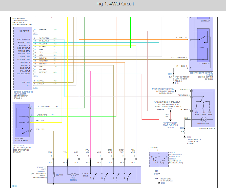

I just bought a ford ranger 4 wd today from a dealer. When I test drove it, everything worked. I went to take my wife for a drive and the 4 wheel drive lights (low and high) kept flashing as I drove. I stopped and attempted to put the car in 4 wd and it would not engage. Please help me.

It sounds like you have the same type of luck as I do. Have you checked for power to the actuator on the transfer case? (Can you hear the actuator shifting when you select 4wd?) Also, check the vacuum hoses going to the front axle near the hub assembly. Make sure they're in good condition and not damaged.

It sounds like the actuator is going bad. It is the electric motor on the transfer case that engages the 4wd. When this happens, check to see if there is power to the actuator. IF there is, chances are it is bad.
Let me know what you find.

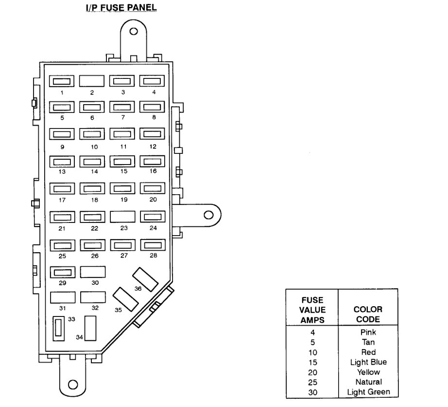

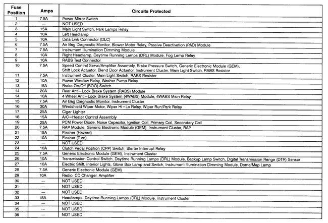

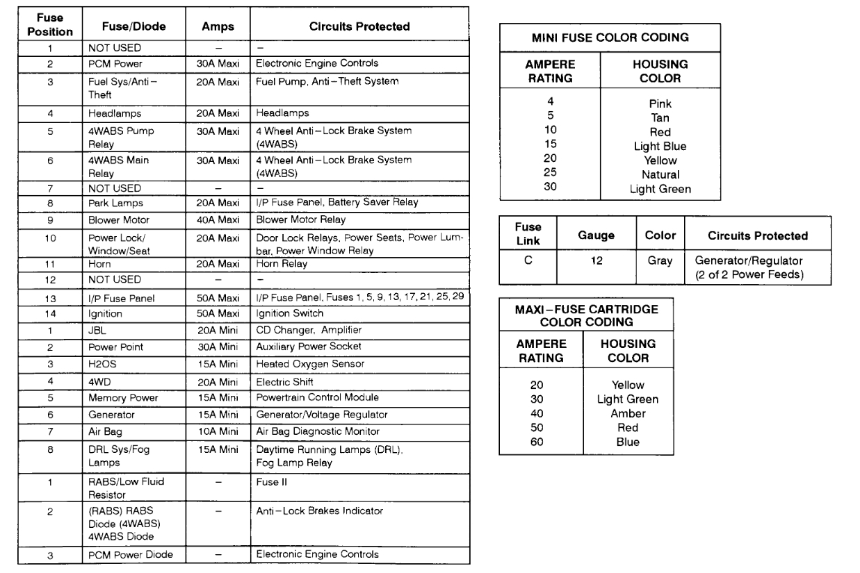

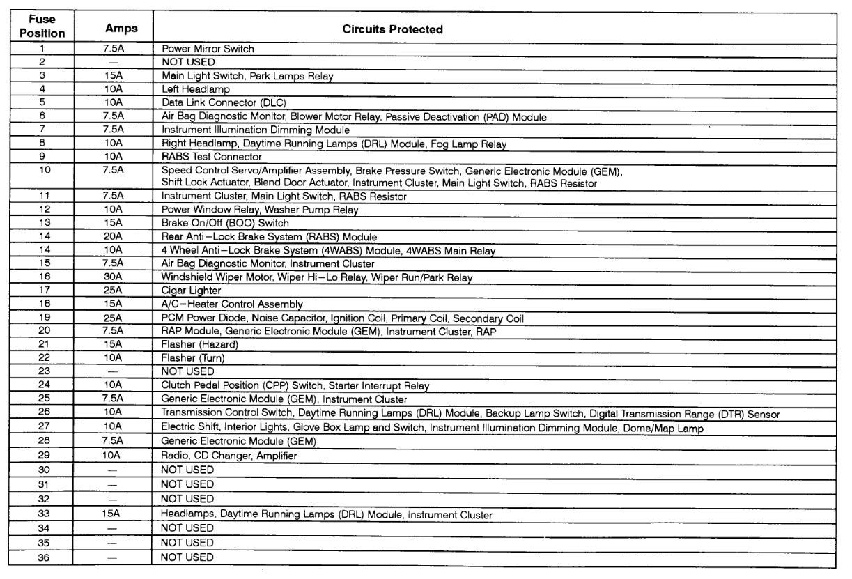

98 ford ranger 6 cyl 5 spd 120,000 mi. The yellow 4wd indicator lights on dash come on when I start the veh and then turn off like the rest of the start-up lights. When I turn the knob to engage the 4wd nothing happens, it stays in 2wd. 4wd does not engage (High or Low) and regardless of the position of the 4wd knob the 4wd indicator lights on the dash occasionally flicker while I drive. However when they flicker, that is all that happens, there is no 4wd activity or noises to indicate something is trying to happen. I checked all the fuses near the door panel and they all look good. Could it be the switch itself?

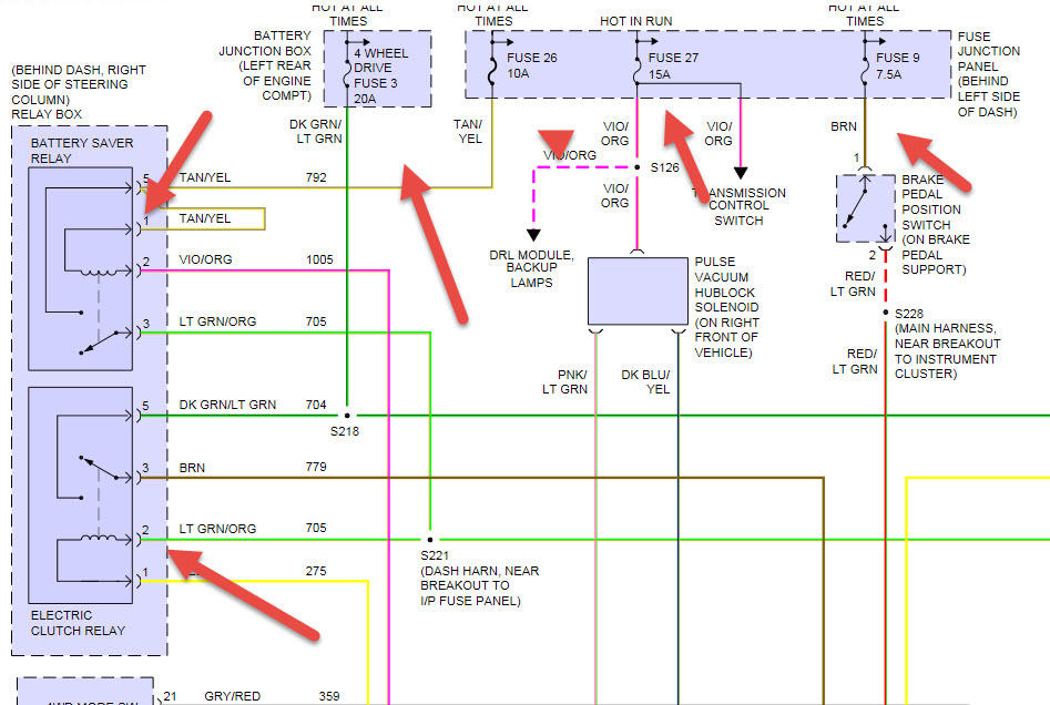

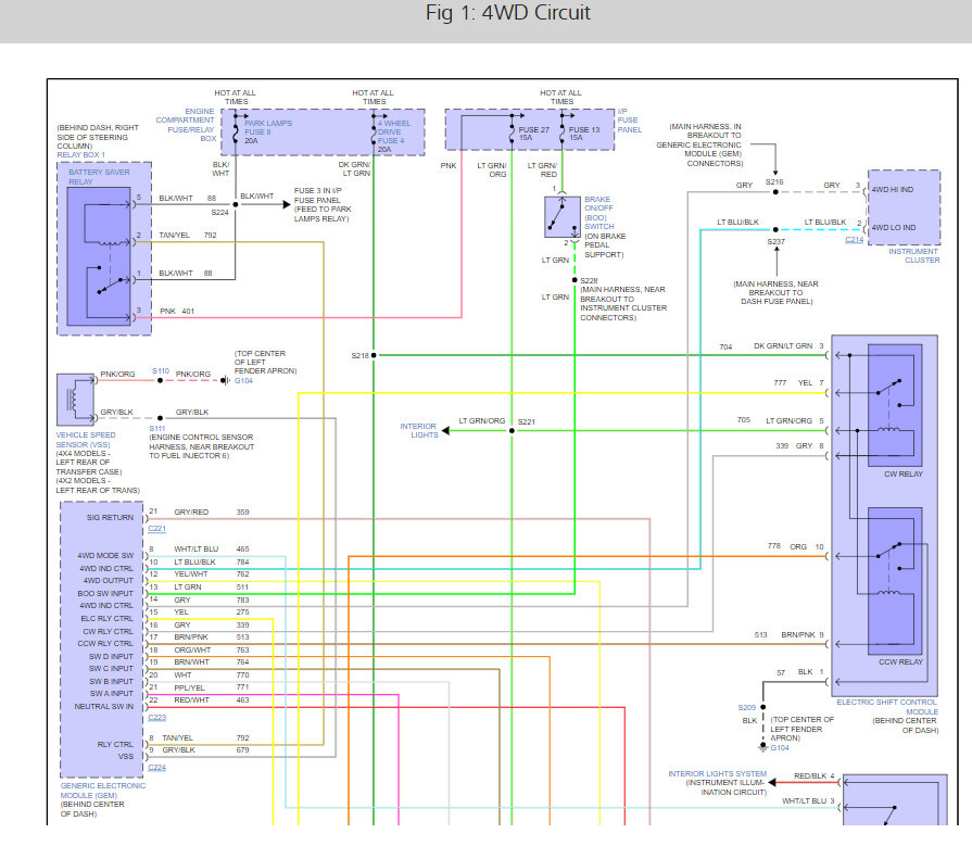

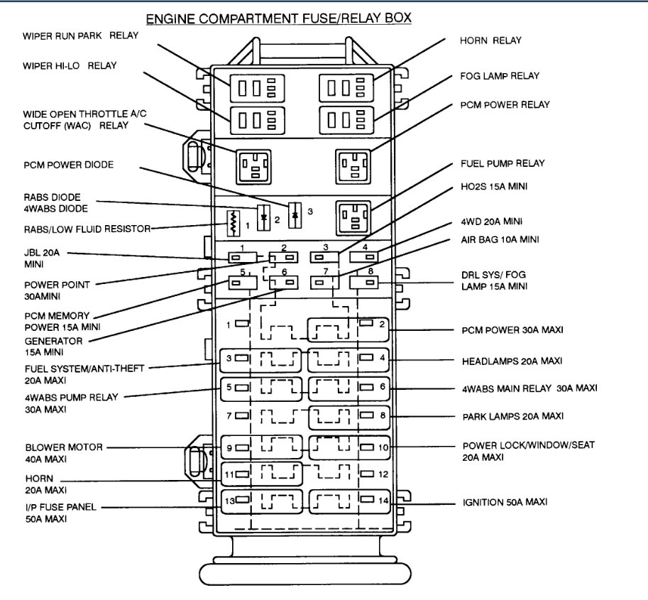

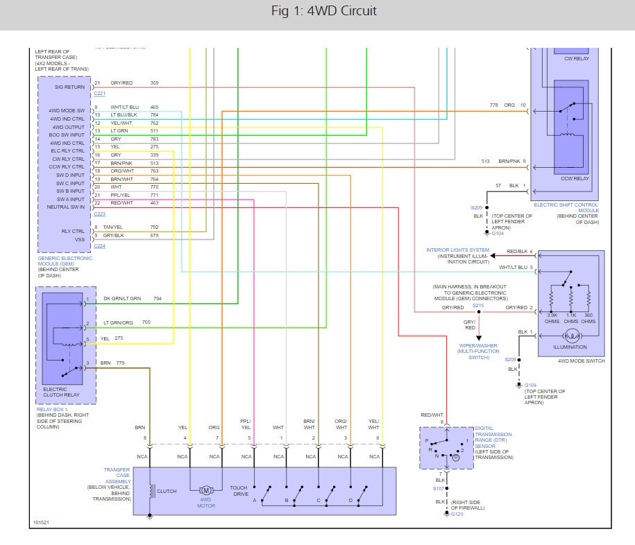

I used my four wheel drive on my 98 ford ranger like a month ago worked fine then a week later I went to use it again and the 4hi and 4lo lights started flashing and hasn't worked since. Been trying to figure out if its the switch or transfer case. I checked all the fuses and they're all fine. And it seems like everyone has a different answer for what's wrong with it. And I don't wanna just go out and by random parts and play a guessing game. Oh and I remember when I put on my manual lock hubs on it a couple of years ago I plugged off one of the vacuum hoses so I unplugged it and put it back where it originally was and now the four wheel drive lights stopped flashing but it still wont go into 4hi or 4lo. So what could the problem be? Its a older truck with 225,000 miles on it but it runs and drives really nice and is in really nice shape with very little rust. I've taken very good care of it and wanna drive it till its completely retired.
+1
Monday, January 13th, 2020 AT 7:29 PM (Merged)
HMAC300
  • 48,601 POSTS
Scan for codes first a pro may have to do it. Check items in pic as well.
