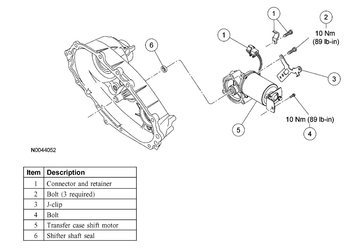

when u switch to 4 wheel drive does nothing
Jun 12, 2010 at 7:46 AM
  • 110,244 POSTS
Have you checked to see if you are getting power to the actuator on the transfer case? The actuator is a pretty common problem
Check out this guide on using a test light

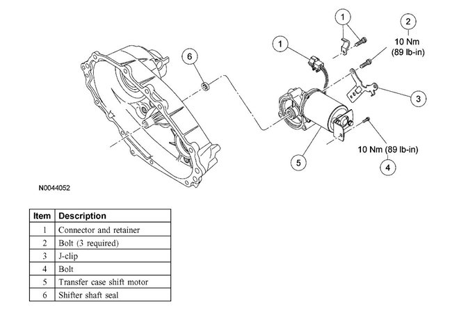

Heres the instructions to change the actuator if it tests bad
1. Set the MSS to the 4x4 HIGH position.
2. With the vehicle in NEUTRAL, position it on a hoist.
3. Disconnect the transfer case shift motor connector.
4. Remove the bracket bolt and the transfer case shift motor bolts, then remove the transfer case shift motor.
^ To install, tighten to 10 Nm (89 inch lbs.).
5. Remove the grease from the motor adapter and check for any nicks or burrs. If any damage is found, repair or install a new transfer case shift motor as necessary.
6. To install, reverse the removal procedure.
^ Apply a coat of multi-purpose grease to the transfer case shift motor.
Pictures are attached below
