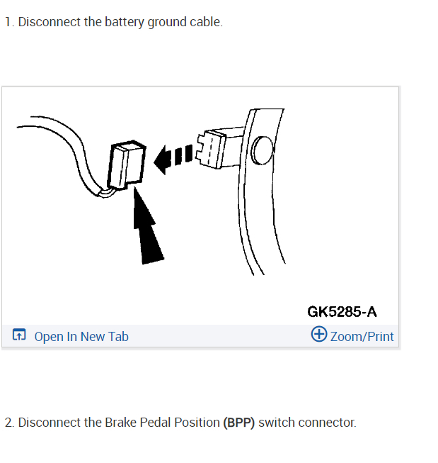

The brake lights don't work when I push the pedal down. I have checked the fuses and the bulbs. I have been told I need to change a "stop switch" which is cheap and easy to do. Is this accurate information and where is this "stop switch" located?

The switch is located at the top of the brake pedal

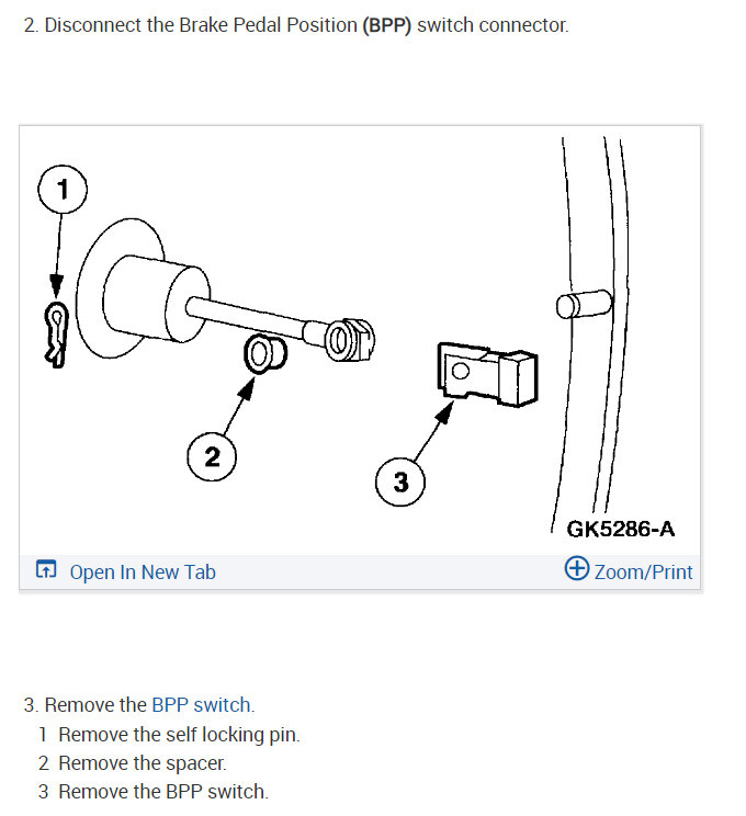

Here is the location of the brake light switch. Check out the images (below). Let us know if you need anything else.
