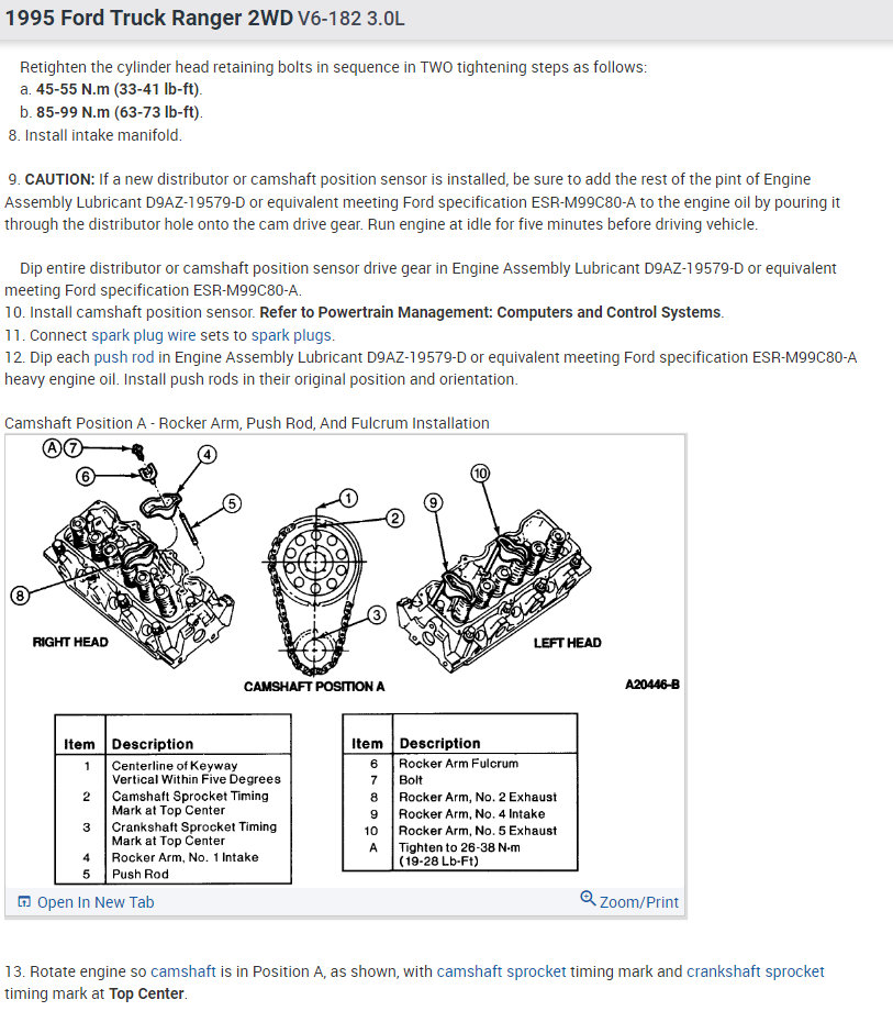

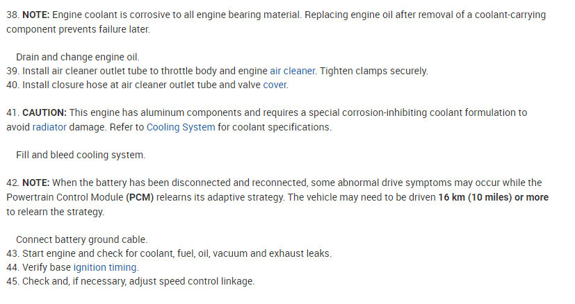

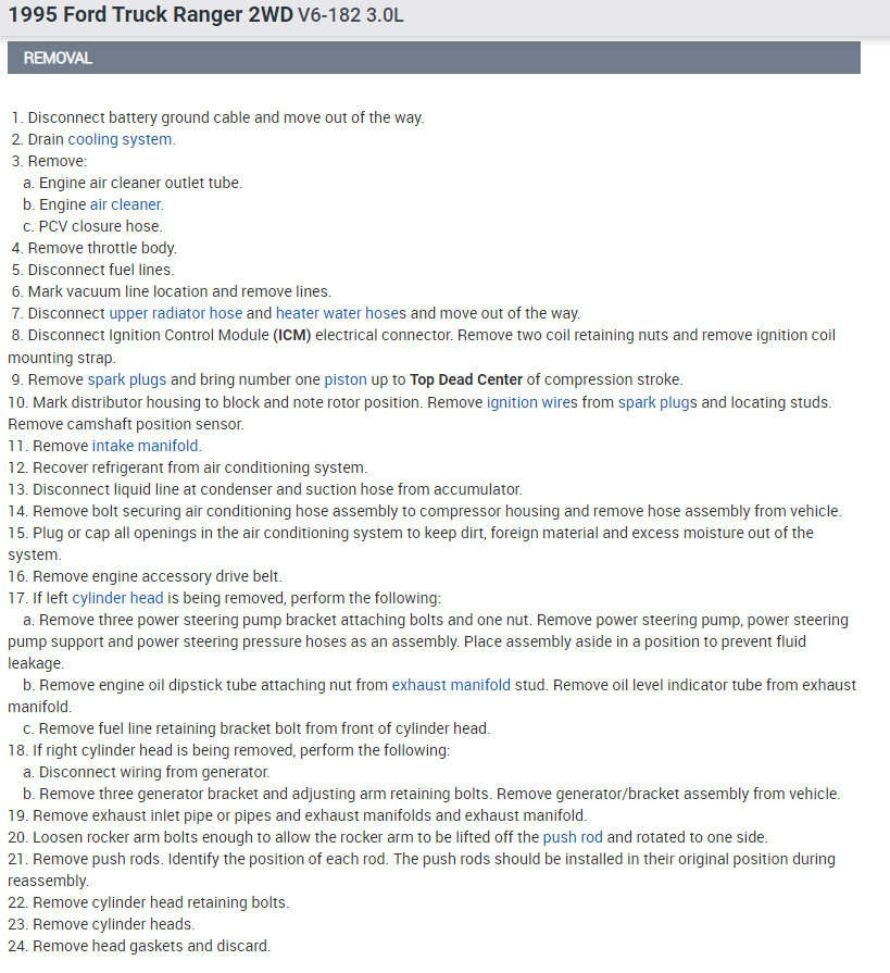

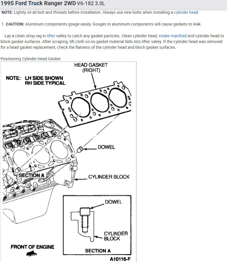

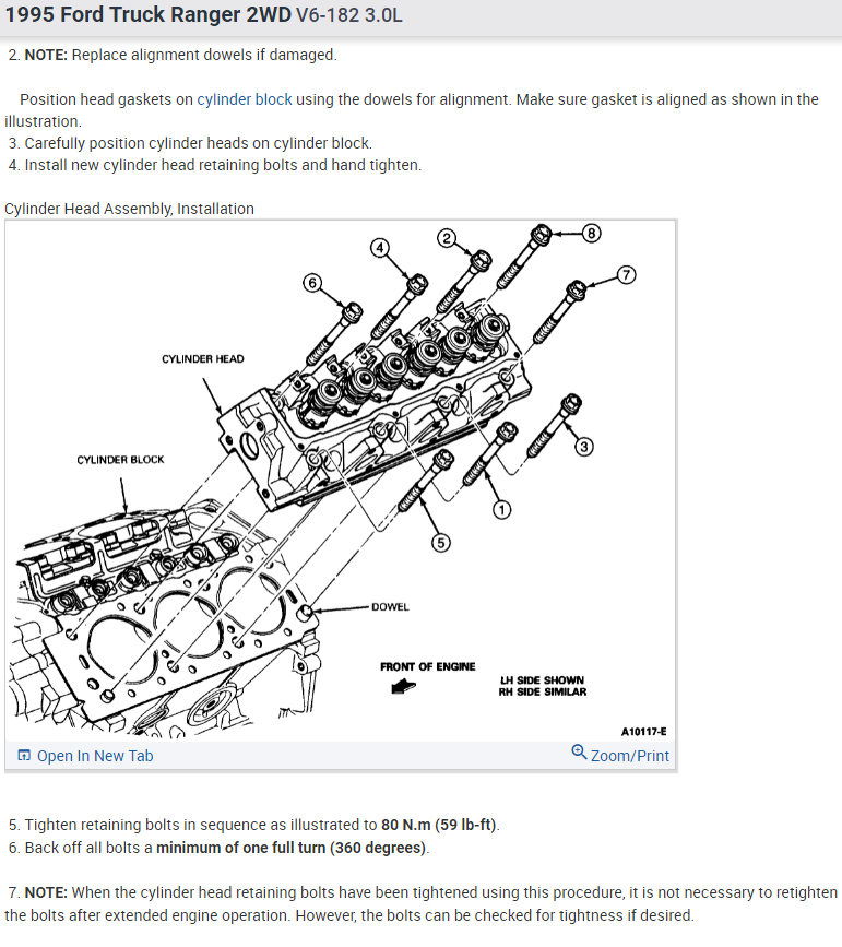

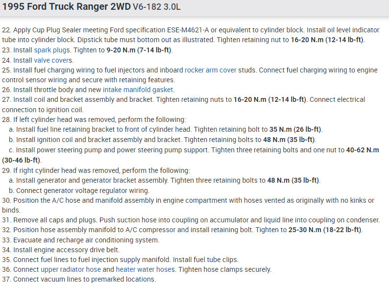

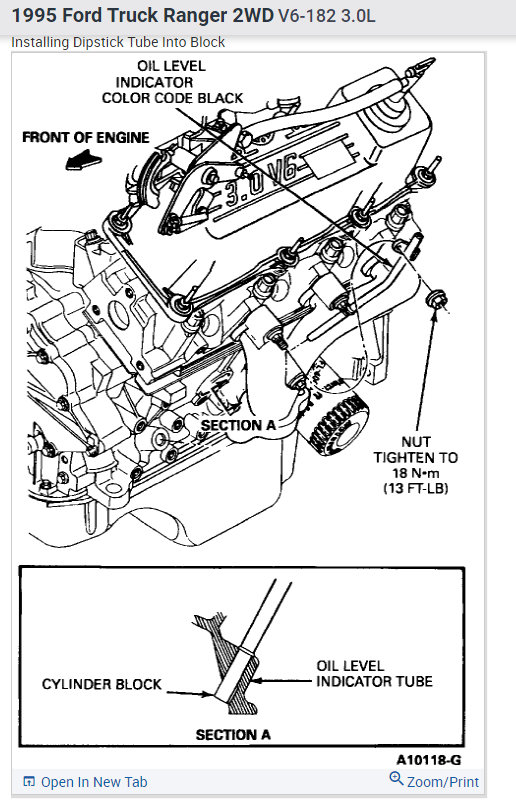

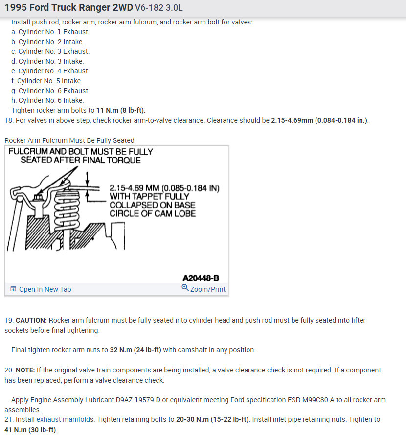

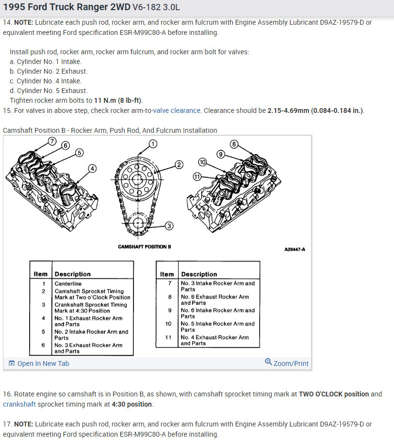

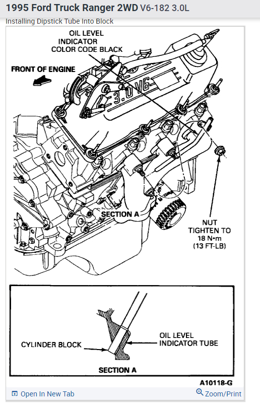

I have attached head gasket replacement procedure for your reference.
