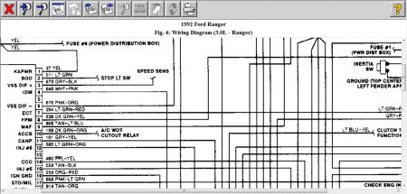

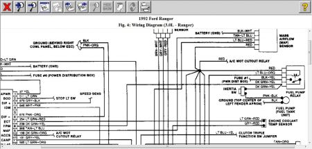

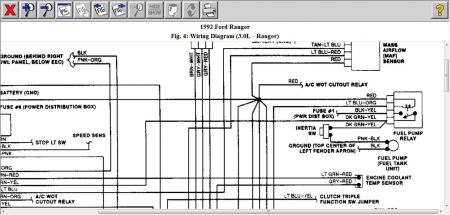

I'm now looking for wiring diagrams, if there's one around here please point me to it.
When I try to start it, the fuel pump won't 'wind up'.
I break out the voltmeter and see that I have power (12vdc) on the switch side of the pump relay. However when i turn the ignition on, the relay coil terminals has only 2.x volts...I assume it should be about 12vdc to switch the relay and send power to the pump. Where does this power come from and what could be causing the drop?
The wires that bring the relay on are _red_ and _blue+orange stripe_. Looks like the blue w/ stripe is #24 at the firewall Tstrip.
I've jumped out the relay and the pump is working, but still won't start.
Thanks for any help.

Check out the diagrams (Below). Please let us know what you find. We are interested to see what it is.

Don't come out right this time, give me your email addy
https://images.2carpros.com/forum/automotive_pictures/12900_fp1_36.jpg
https://images.2carpros.com/forum/automotive_pictures/12900_fp2_16.jpg

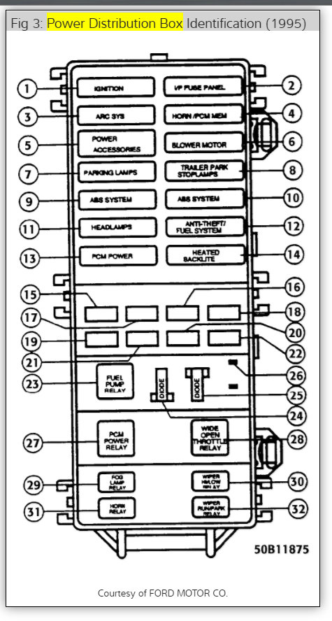

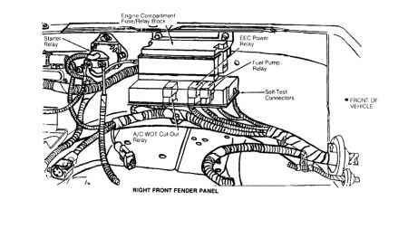

WHERE IS THE FUEL PUMP RELAY LOCATED ON THIS VEHICLE
Nov 24, 2020 at 12:17 AM (Merged)
INTERNETMECHANIC
  • 700 POSTS
My info showed under the hood passenger side.
https://images.2carpros.com/forum/automotive_pictures/512072_ranger_fuel_pump_relay_1.jpg

would like to know were the fuel pump relay is.
  • 75,988 POSTS
https://images.2carpros.com/forum/automotive_pictures/12900_fp_12.gif
