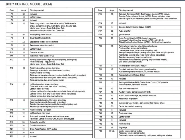

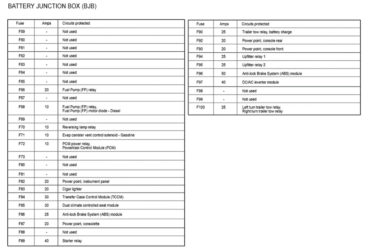

My truck has the engine not running. I need to check the fuses where are they and can you help me check them please?
Dec 2, 2014 at 10:24 AM
  • 110,194 POSTS

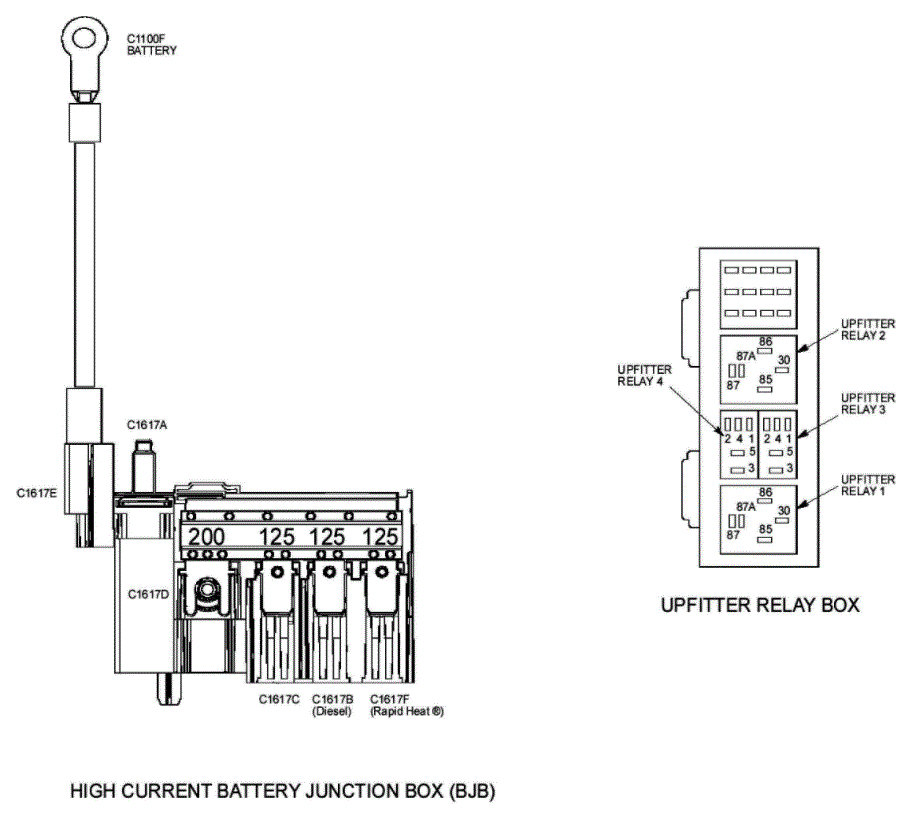

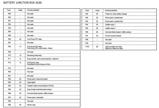

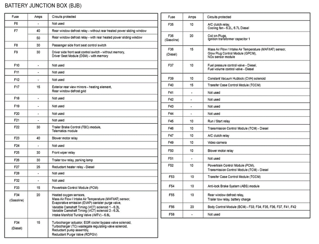

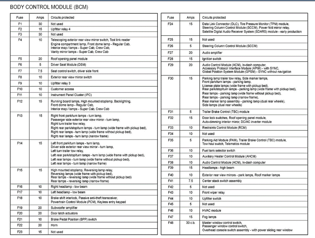

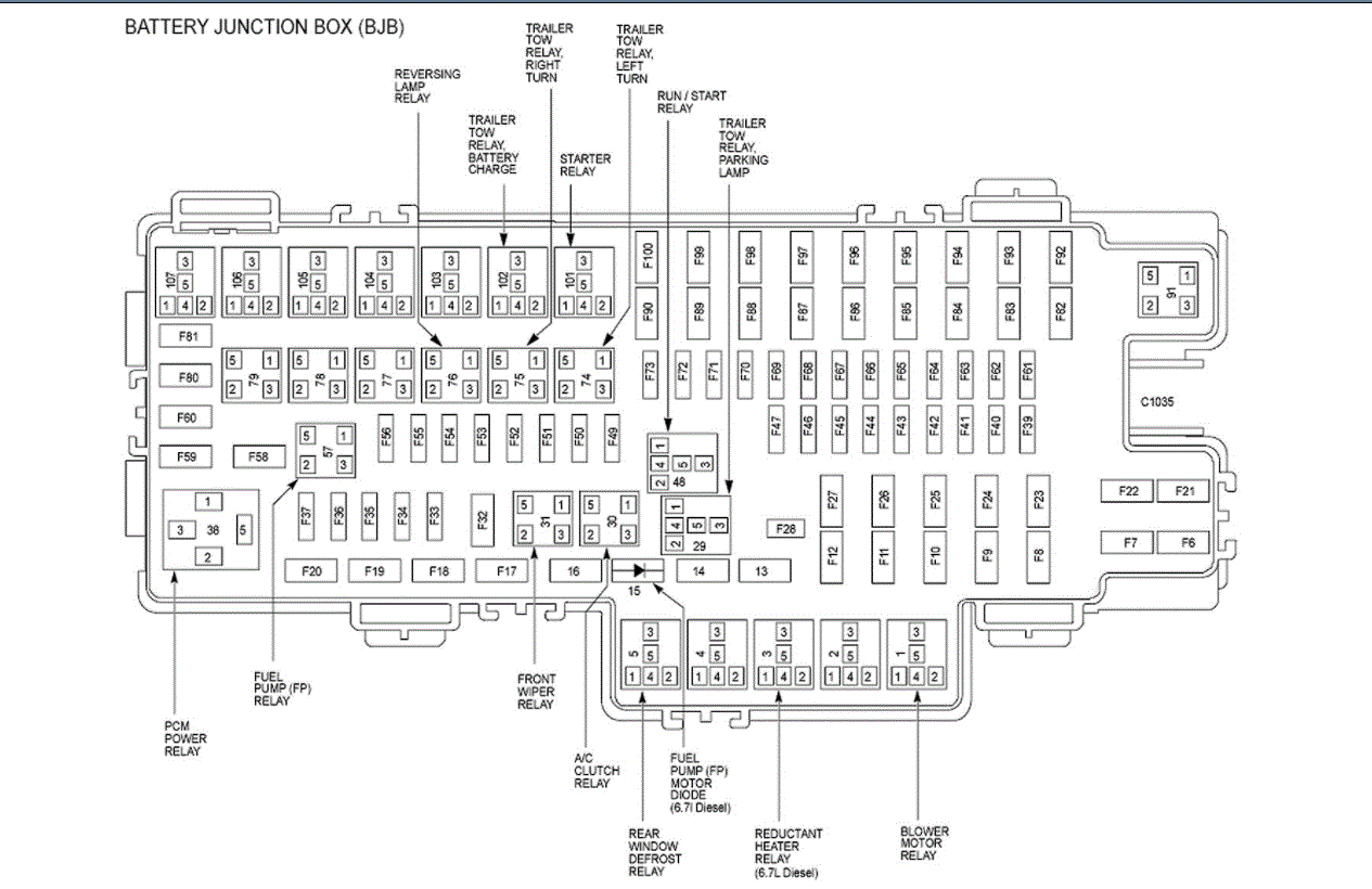

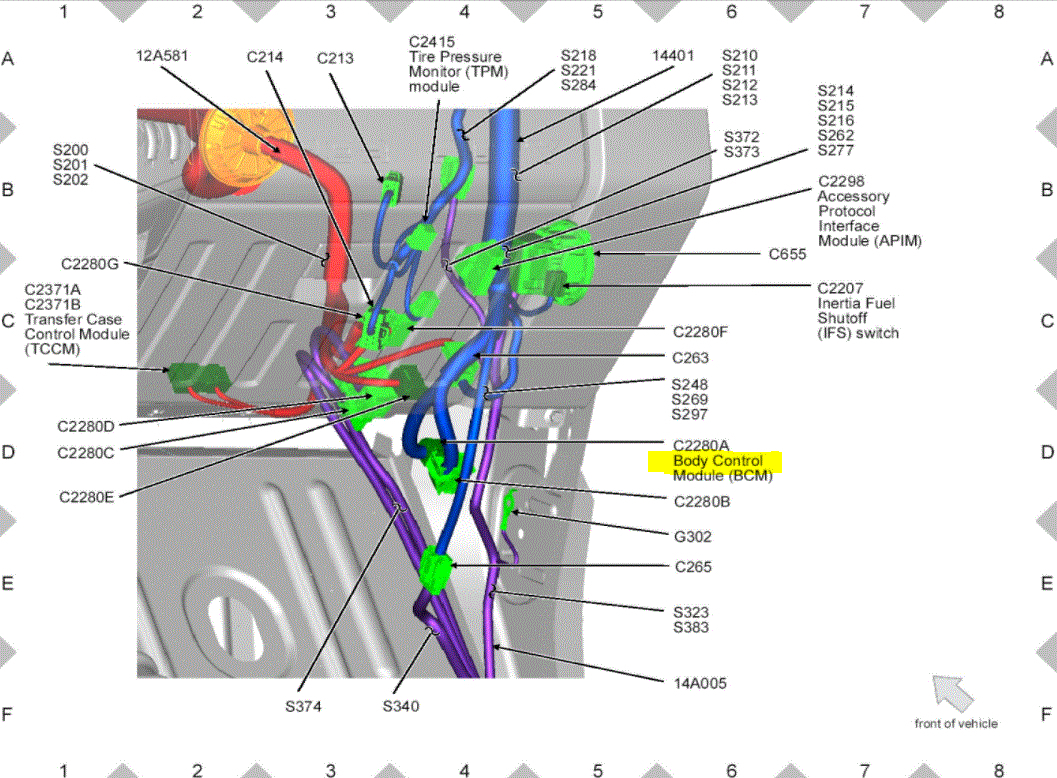

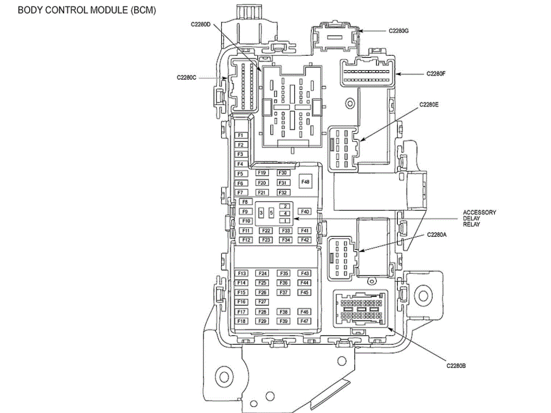

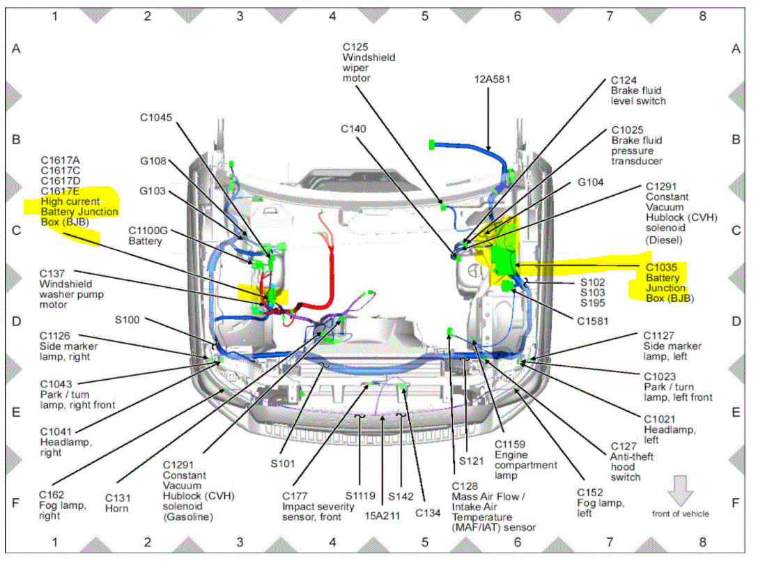

If you look at the attachments below, they provide the fuse box orientations and what each fuse is for. One of the fuse boxes is under the hood on the driver's side and the other is in the vehicle under the dash on the driver's side.
Pic 1 shows locations under the hood. The BCM is under the dash behind the glove box.
In addition to just checking a fuse, make sure there is power to it. A fuse may be good and not be receiving power.
