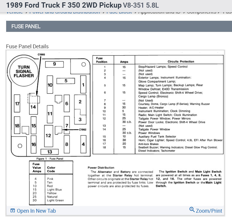

what is the location of the fuse link that protects the ignition switch and fuse panel feed on my truck ? it has a 7.3l diesel engine. thanks for your help and quick response.

Here is a guide to help you test he fuses and the fuse panel identification below.
The links are on the starter solenoid. Check out the diagrams (Below). Please let us know if you need anything else to get the problem fixed.
