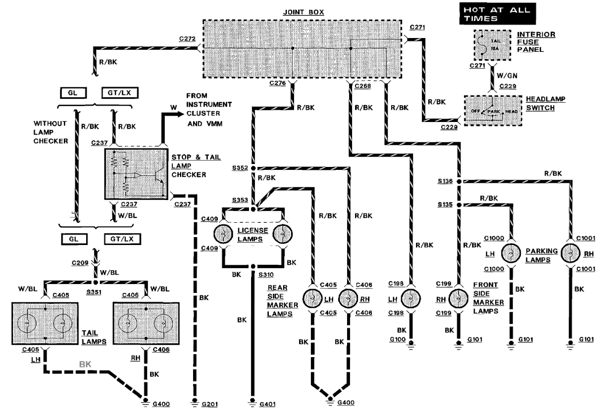

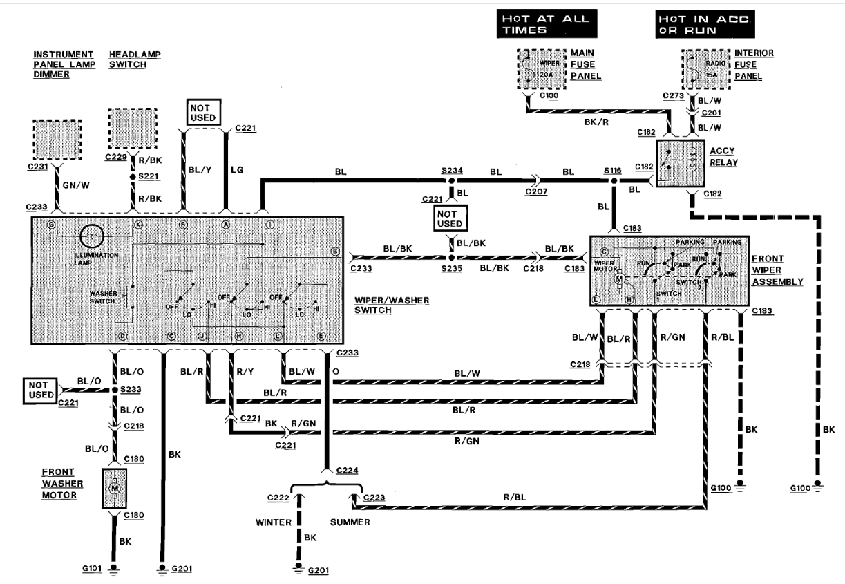

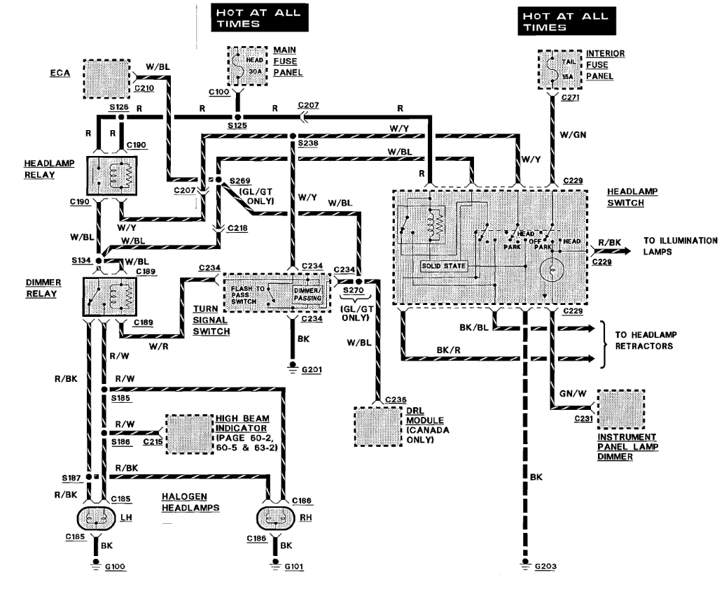

I'm a soldier stationed in Germany I bought a 92 ford probe that has several electrical problems
Headlights don't work (right eye don't rise)
Left tail light don't work
Windshield wipers won't stop.
I need help on went to start troubleshooting, and where can I find the schematics

I would start by checking the fuses, here is a guide to help and I have included the wiring diagrams you need for all three systems.
