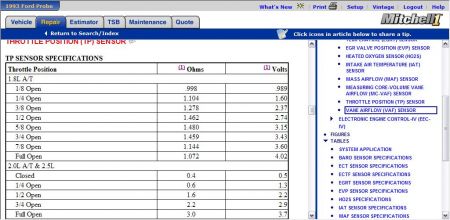

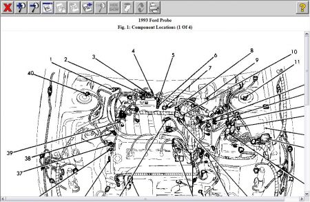

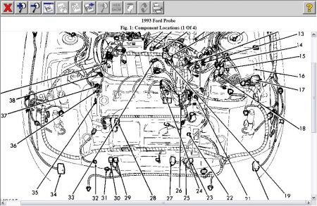

Lets try the idle air control valve at no.19 take out it and clean it and also the throttle position sensor at no.10 check its closed and wide open voltages at close 0.5v at wide open 3.7v Might also want to open up the EGR and clean the carbon

Remove and clean the idle air control valve, verify throttle position sensor voltage (about 0.5V closed and 3.7V wide open), and clean carbon from the EGR valve.
