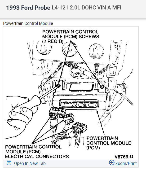

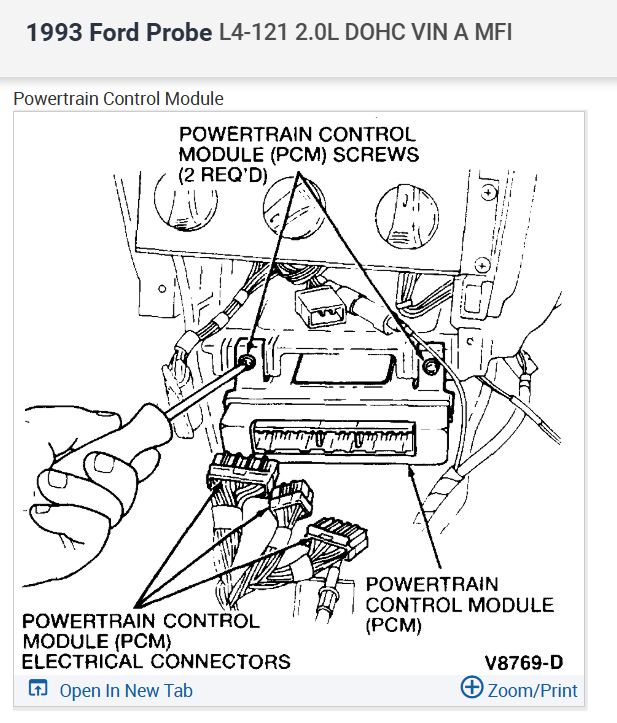

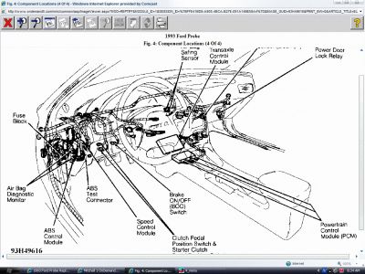

Can I replace the computer of a Ford Probe with another being the same make and model? If so, where can it be located?
Jun 29, 2008 at 8:38 PM
2CARPRO JACK
  • 11,533 POSTS
The PCM in that car is behind the center of the dash, forward of the center console. As far as swapping PCM's, the car has to be the same exact year, engine, trans, if possible see if the part #s match up as well
Jun 30, 2008 at 12:37 AM
MERLIN2021
  • 17,250 POSTS
You should be able too, there will be a sticker, or part number, just make sure they match!located in the center console.
https://images.2carpros.com/forum/automotive_pictures/62217_PCM_3.jpg
Jun 30, 2008 at 12:39 AM
  • 55,443 POSTS
The engine control module is in the center console. Check out the images (below). Let us know if you need anything else.
