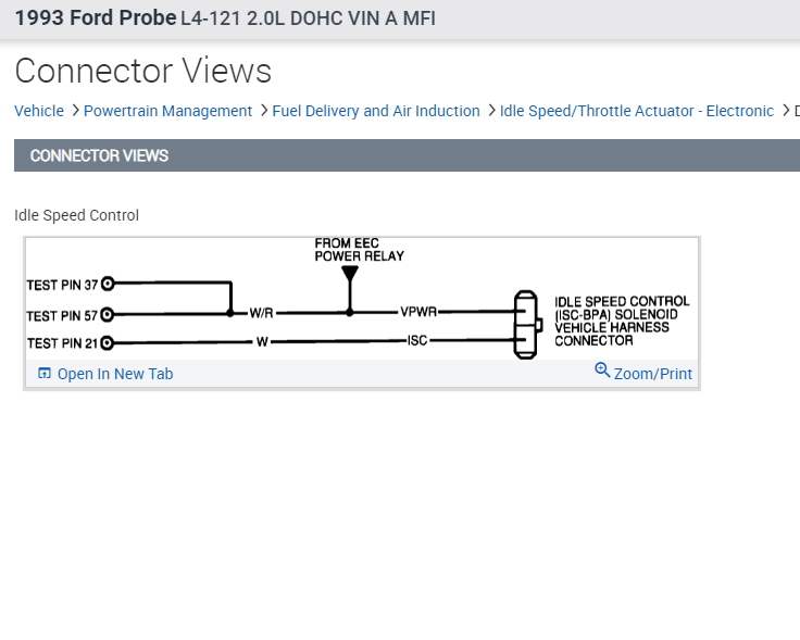

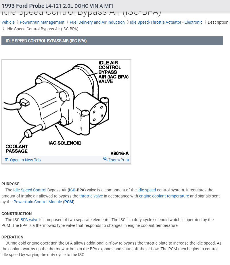

i can get it to start but it wont idle i have to keep my foot on the gas to keep it going?
Oct 19, 2010 at 8:29 AM
SQM
  • 6,383 POSTS
It sounds like the issue is with the idle air control valve.
The idle air control valve is designed to provide air to the engine while it is at idle.

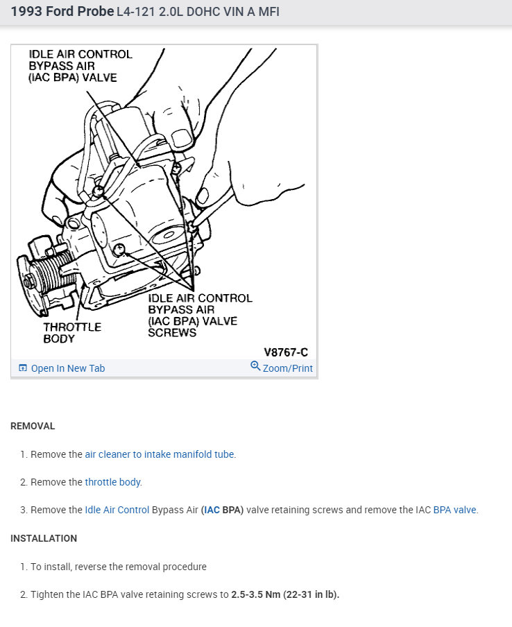

Over time the idle air control valve can get dirty and accumulate dirt and debris inside. This will restrict air flow. As a result, the engine idle will suffer.
Sometimes cleaning out the valve can improve the idle quality.
