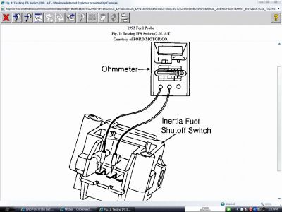

The other thing you might want to look at, are there any codes? Check engine light on or flashing? Also test that inertia switch, it could be the reason the fuel keeps shutting down. Where does the KNOCK sound like it's comming from? The lower part of the engine, or the upper? Your knock sensor could be shutting the engine down, if you already have a mechanical problem with the motor, it will have to be repaired!
https://images.2carpros.com/forum/automotive_pictures/62217_Inertiab_1.jpg
https://images.2carpros.com/forum/automotive_pictures/62217_Inertiaa_1.jpg

MERLIN2021
  • 17,250 POSTS
This is to TEST the inertia...if it.s not functioning correctly it will do strange, not predictable things!

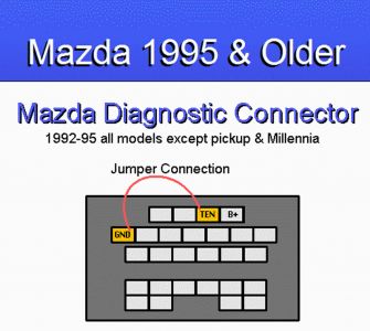

MERLIN2021

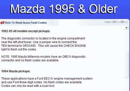

  • 17,250 POSTS
https://images.2carpros.com/forum/automotive_pictures/62217_95_OBD_OLDER_1.jpg
https://images.2carpros.com/forum/automotive_pictures/62217_95_OBD_OLDERa_1.jpg
Clearing codes, Carb models: Disconnect negative battery cable for ten seconds. FI Models: Disconnect negative battery cable for ten seconds then press brake pedal five times.

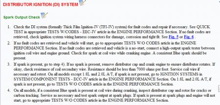

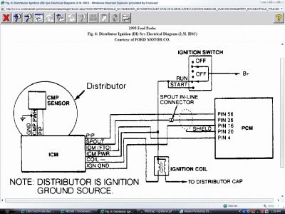

MERLIN2021
  • 17,250 POSTS
https://images.2carpros.com/forum/automotive_pictures/62217_Ignitionb_2.jpg
https://images.2carpros.com/forum/automotive_pictures/62217_Fig6_2.jpg
Gennerally with Fords, it turns out to be the TFI module, screwed to the side of the distributor.
