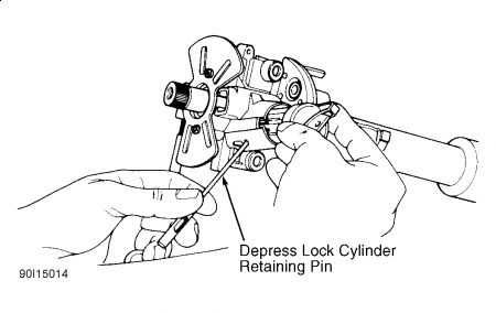

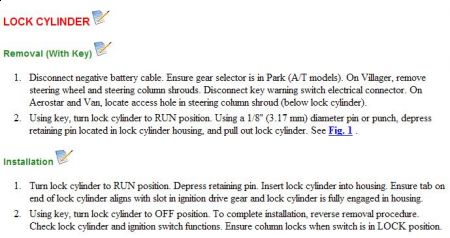

Here are the correct replacement steps to help you on your way....
https://www.2carpros.com/forum/automotive_pictures/261618_Noname_1510.jpg
FIG. 1
https://www.2carpros.com/forum/automotive_pictures/261618_Graphic_288.jpg
Tuesday, January 26th, 2010 AT 11:26 PM

I succeeded! I followed the packages instructions, missed bluelightnin's response.
Here is what I did looks very similar. Disconnected the negative terminal. Turned key to the ON position as if it were running, took a thin long phillips screwdriver and poked the hole farthest from me (2 holes). Pulled on the black part of the ignition, not the keys and slid it right out. Slid the new mechanism on. The key didn't pull out so easy, so I took the ignition cylinder out and back in again, and that fixed it. Reconnected negative terminal and works fine now.
Took about 45 minutes, 30 minutes of which were going wal-mart to get a tool to remove a bolt on the negative terminal :).
