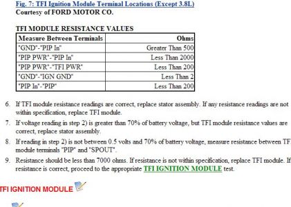

I have an 84 Lincoln Town Car. It has 120,000 miles. The night before I heard a couple of putters while driving home. The next morning my car wouldn't start. It isn't firing. I have had the electrical box on the distributor checked and they said it passed. The mechanic hooked up a new coil and it still didn't start. He is thinking it may be the wiring in the ignition switch. Is there anything else we can check easily to see if that is the problem, or is there something else we should check? There were a few times in the beginning of trying to just turn the key and start the car that it seemed to try to fire as I was turning the key back to the off position from it being turned all the way on (trying to start). Right when the car was at the last movements of the turn back from starting to on (to listen to music), the car would sound like it was trying to start. Any ideas? What should I tell the mechanic to look at.

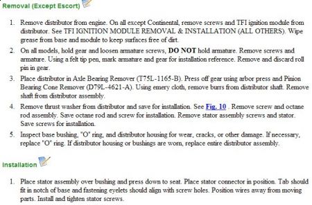

Well, the "sure fire" way to tell is to plug the module back in and just put in one screw to ground it and turn the key to crank. Checking one plug wire, if you've got spark we look else where. Again, let me know.' EDIT; I just had another thought. It's just possible, kinda' sorta' maybe, it could be the pickup coil inside the distributor. I can't remember ever having to change one. But, just maybe. If you plug the module back in and have no spark, I'll copy the PU coil resistance test for you. What motor do you have? The 3.8???
