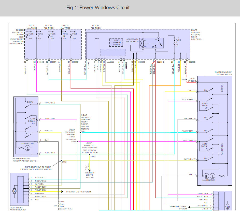

I recently replaced my battery due to corroded terminals and the battery being unable to hold a charge. It was left for 2 days without a battery, and now the driver side window doesn't do the automatic one touch roll up, and it rolls up too far...when I shut the door normally, the windows move up on their own into the door frame. It is not doing that any longer and now when I roll the window all the way up, and shut the door, the glass is on the outside of my door and bows out. What could make it stop working all of a sudden, and does it have anything to do with the battery being disconnected for a period of time? How do I fix this?

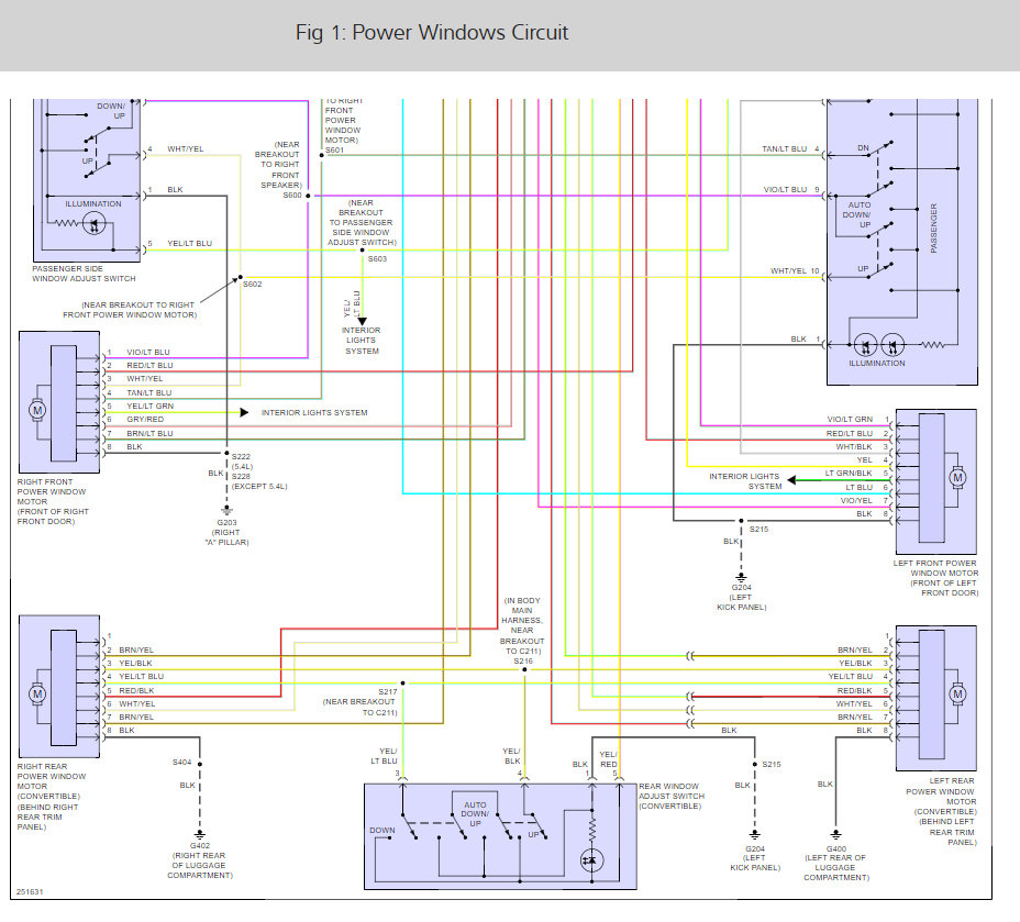

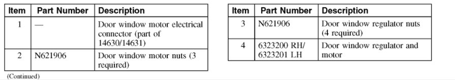

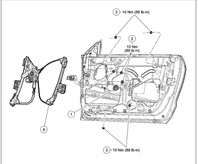

It sounds like when you reconnected the battery the voltage surge took out the window motor control which is right in the motor. Here is a wiring diagram and a guide to help you get the motor changed out.
https://www.2carpros.com/articles/how-to-check-and-replace-a-electric-power-window-motor
Check out the diagrams (Below) are how it is done on your car.
