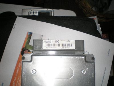

Is this the PCM and how do i get it checked?

I don't know what they will charge, but yes Ford can test/ reflash them out of the car...
Oct 2, 2008 at 8:33 AM

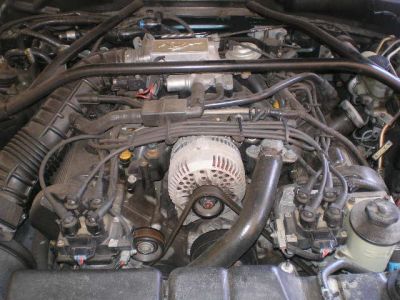

Did not work, It blows the ecc fuse everytime, i tried unhooking the computor, fuse blows, unhooked the coils fuse blows what else goes thru that fuse? 96 mustang gt

here is a pic of my engine

They arent meant to! All the testing info is in the posts! Your problem is a simple as tracing the wires out of the fuse box, or CCRM.

I traced wires back from the fuse and inserted fuses and disconnected components. The second try i disconnected the air conditioner compressor and the fuse did not blow and the car started right up. The air bag light does not blink but it is staying on.

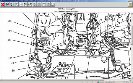

where is the CCRM located on a 1996 mustang?
Oct 9, 2008 at 9:33 PM
MERLIN2021
  • 17,250 POSTS
On the bracket behind the coolant reservoir. #33 in the picture
