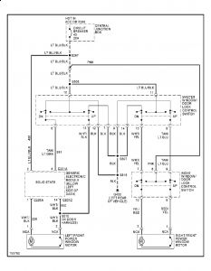

my driver side window in down and wont come back up. I can here a clicking sound but nothing will happen. Is there a fuse I should check or what shall I do? I don't have a manual to look this up

the fus is number 43 in the fuse box, it is a 20 amp fuse. The fuse would not be bad if the other window works , they work off the same fuse. The switch could be bad or the window motor is bad. I would look the window switch more than the motor. Here is a diagam of the electical circuit.
https://images.2carpros.com/forum/automotive_pictures/54223_Graphic_4.jpg
