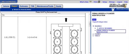

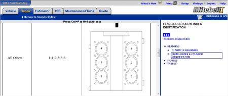

I need a picture diagram, I removed the wires and forget how exactly they go? From the coil to the plug 123 on left side, 456 on the right? I thought I knew but car running like crap? Need a picture though or ill be confused? Thank you so much

https://www.2carpros.com/forum/automotive_pictures/12900_fo1_15.jpg
https://www.2carpros.com/forum/automotive_pictures/12900_fo2_7.jpg
