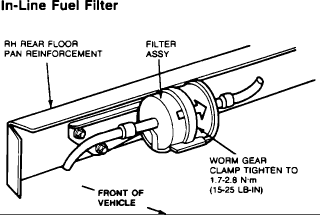

Where is the fuel filter located on this car?
Tuesday, April 6th, 2010 AT 2:07 PM
MECHANIC
75,992 POSTS
Mounted on frame bracket at upper front of fuel tank.
