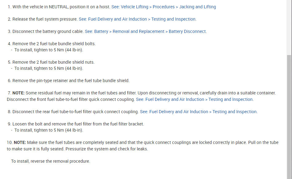

My engine has low power I was told the fuel filter could be clogged.
Friday, May 9th, 2014 AT 11:32 PM
MECHANIC
18,907 POSTS

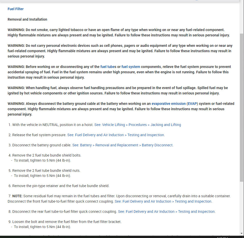

Here is a guide that will help with performing this repair. It is on a different vehicle but gives good detail that you would need.
https://www.2carpros.com/articles/how-to-change-a-fuel-filter
Plus here is a video on an earlier build Mustang that will help as well:
https://www.youtube.com/watch?v=hVHhgLCxhl8
Below is the process from the manual that will help with additional details. Please run through this material and let us know if you have other questions. Thanks
