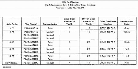

the speedometer needle does not move at all any time I get in the car to drive at any speed.

This could be a.0 the VSS, b.) the gear, c.) the instument cluster, or d.) wires! Heres how to test it...Remember to check the instrument fuses first!
