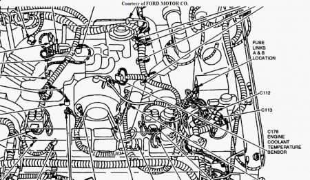

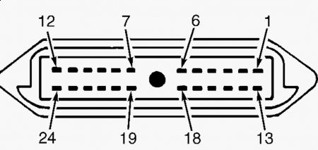

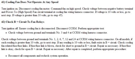

Having problems with the radiator fan not working and also noticed the ac stopped blowing cold air. Dont think its the ccrm cause I replaced it with another used one and still no fan.

Check the Fan fuse in the under hood fuse block, check fan ground and power with ohm meter, if it has power, unplug the fan connector, and run a fuse protected wire from the battery to the fan motor, will it run hooked straight to the battery?
https://www.2carpros.com/forum/automotive_pictures/62217_96ccrm_1.jpg
https://www.2carpros.com/forum/automotive_pictures/62217_ccrma_1.jpg
https://www.2carpros.com/forum/automotive_pictures/62217_ccrmb_1.jpg

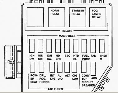

Answer to PM:
Fuse box is on the left fender apron, look for "FAN" 60 amp and EEC 20 amp. Also look at the links, they are right at the same location, use a tets light or tug on them, if they break or stretch, replace them.
https://www.2carpros.com/forum/automotive_pictures/62217_Must_Under_Fuses_1.jpg
https://www.2carpros.com/forum/automotive_pictures/62217_MustLinks_1.jpg
