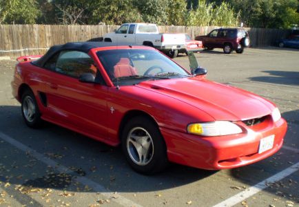

Hi Joe, First the battery isn't quite dead because it made sparks but when in ignition,the motor doesn't start even having the jump start cables on the battery...The oil leak is under the engine and after checking the oil dipstick it didn't show much on it though it was full a month ago when I went to Midas for changing gasket and oil filter,water pump,cooling system inspected .They said it is all fine...and today I had the problems above.They didn't say anything bad about battery either...the leakage isn't very big but still left a mark about 5-8" on the ground.Please help. Ovi
https://images.2carpros.com/forum/automotive_pictures/460778_159_3.jpg

AS far as your car, first, nice picture. I would love to have one. Regardless, I need you to first make sure the battery is fully charged. If you have a volt meter, simply check how many volts the battery is producing. Then have a helper try to start the engine. See if there is a large drop in voltage.
Let me know what you find. By the way, as long as there was oil on the dipstick, I doubt there is any major problems with the engine, even with the small oil leak you saw.
