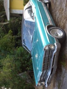

Hello, i recently encountered a problem with my front braking on my LTD 390 72k mile vehicle. I think there is no fluid going through the front wheel cylinders but the brake lines seem fine, i bled the system, replaced the master cylinder and all the wheel cylinders but my brake pedal still is stuck on the ground. How do i get my front brakes working?

one suggestion...if the brakes are good and properly adjusted, You need to re-bleed the brakes with the proportioning valve button held in. Also make shure you get fluid from all wheels...Nice Wheels! I had a 68 XL with a 390!

Re-bleed the brakes while holding the proportioning valve button in, confirm fluid comes from all wheels, and verify the brakes are properly adjusted.
