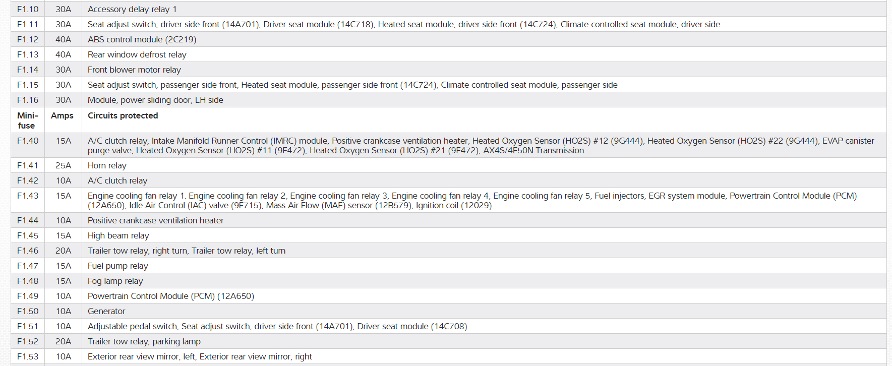

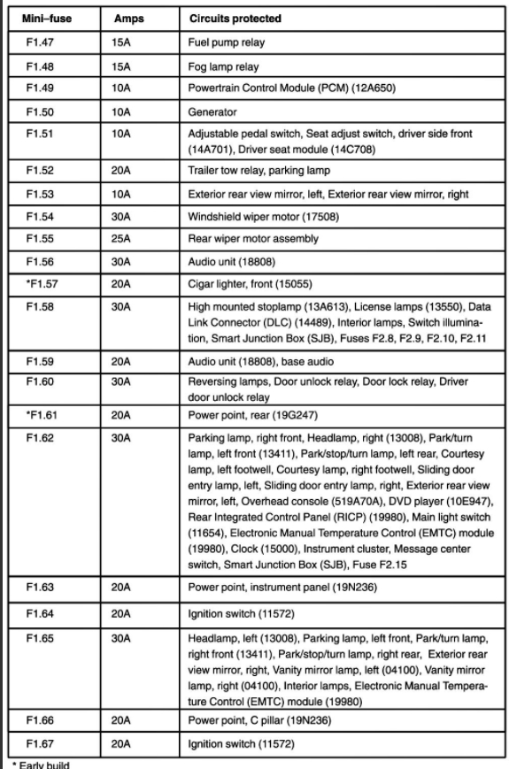

Can I get a fuse panel diagram so I can find which fuse goes where?

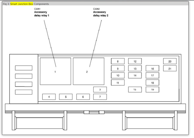

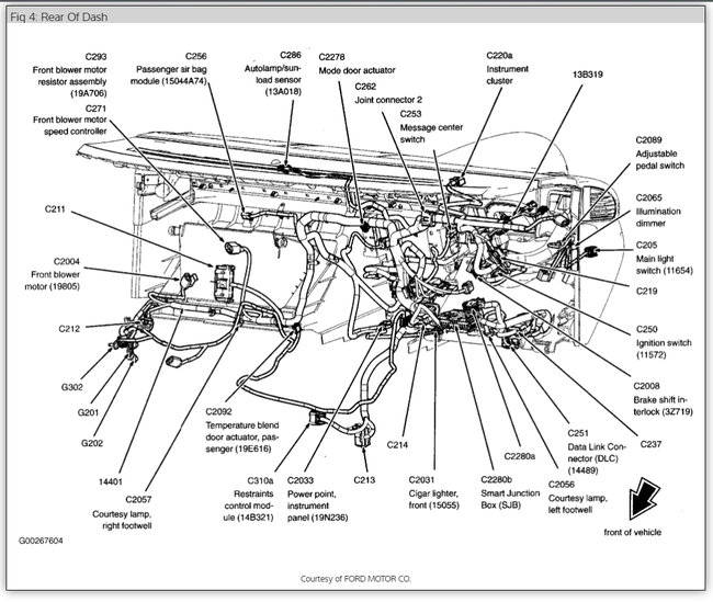

I pulled that "smart Junction" module with the hazard lights engaged and they still ticked on and off regardless, turn signals too.
The actual "tic-toc sound" is coming from near the instrument panel and that's the module I am looking for, but can't seem to grab it to install my EP27L Led module. It's not floor level or by my knees or with the box with the smart junction modules. Do I need to remove the instrument panel to get to the "tic-toc'ing" module?

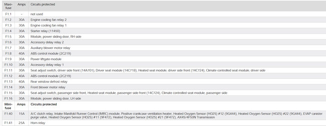

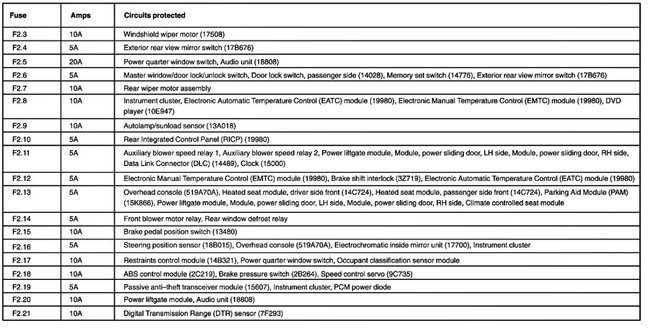

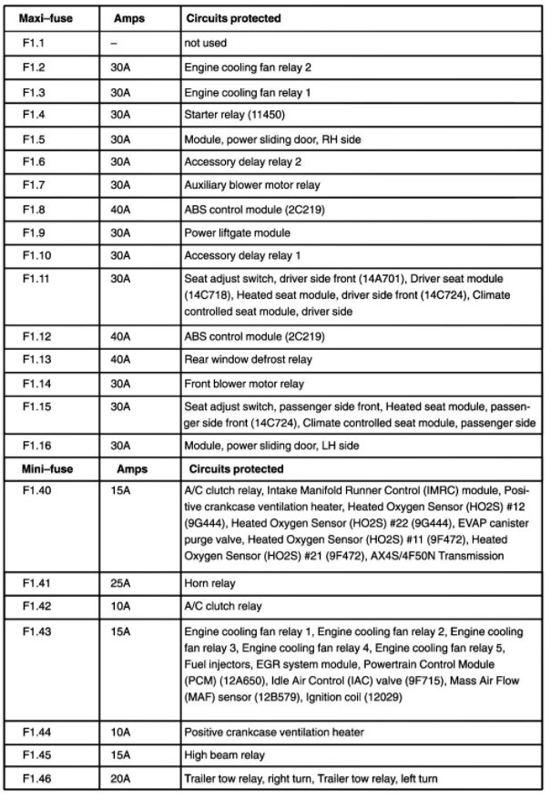

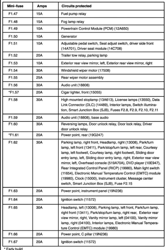

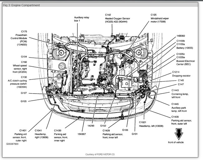

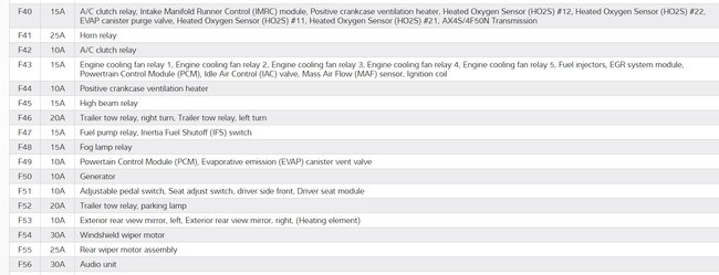

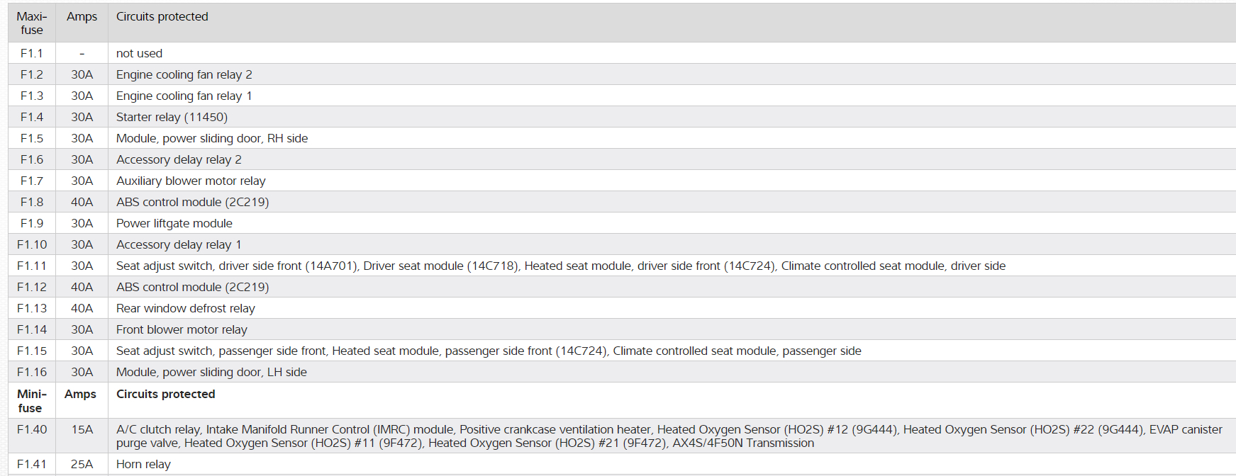

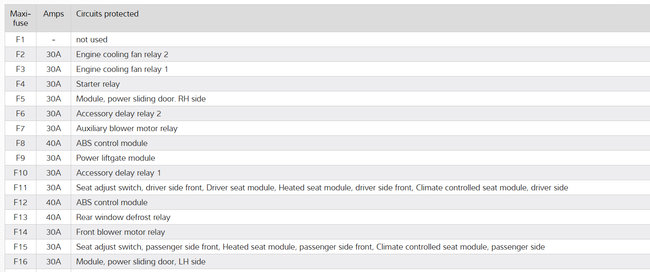

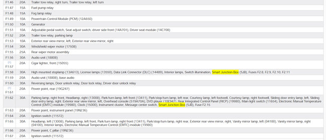

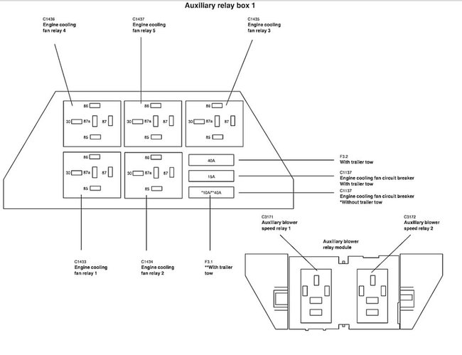

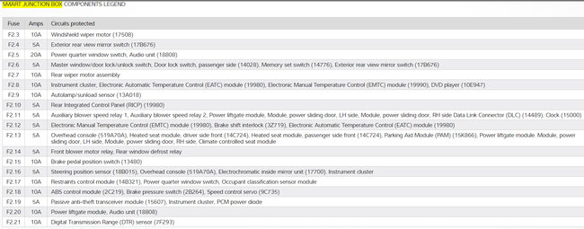

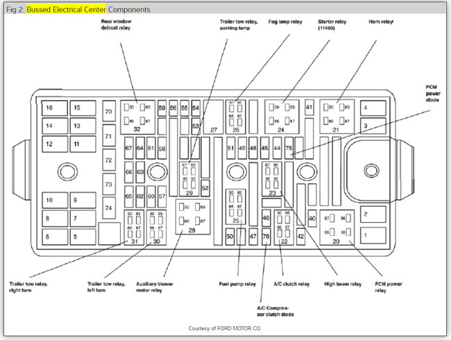

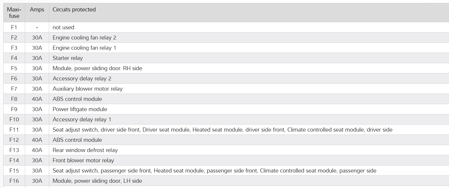

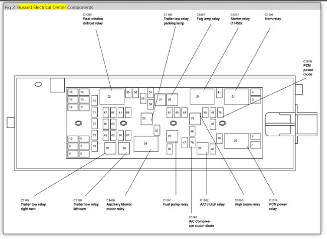

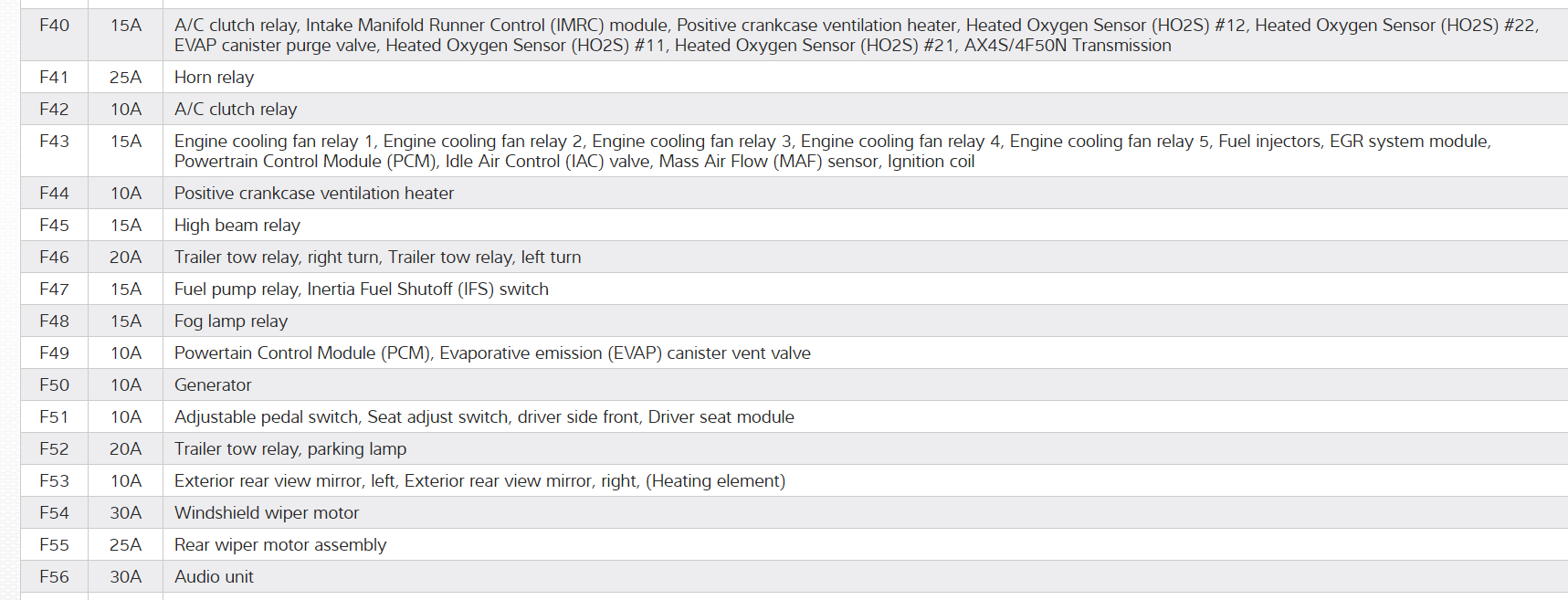

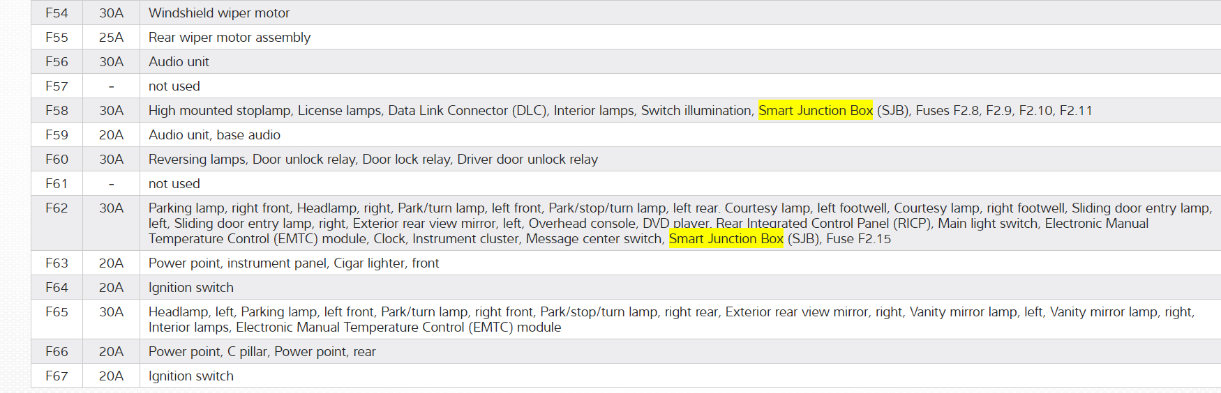

I have found all of the relays and fuses for this car with two guides to help you guys test the systems needed. The fuel pump relay is #25
and
Check out the fuse panel and relay diagrams (BELOW) There are two kinds of fuse panels check them both
