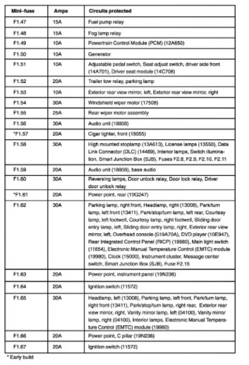

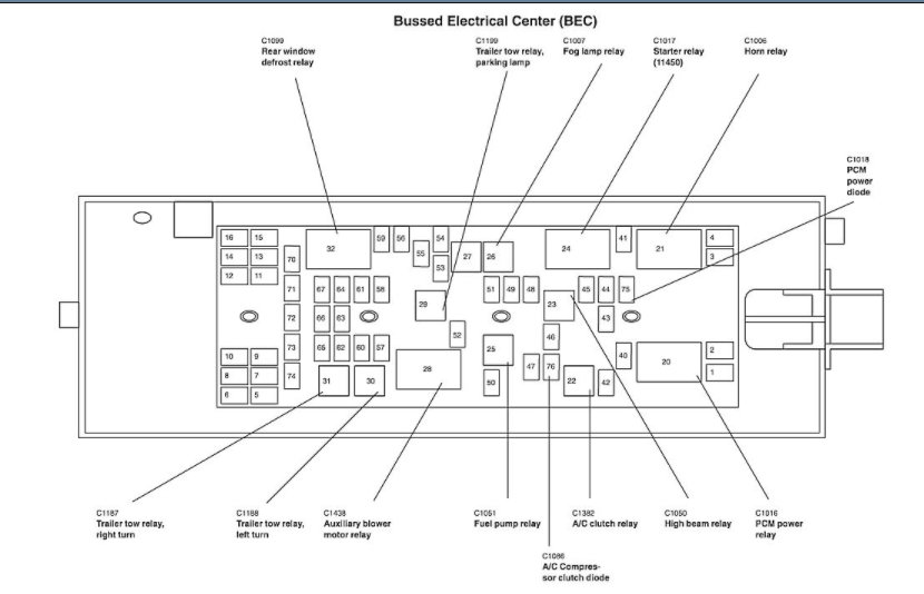

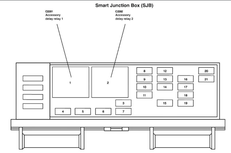

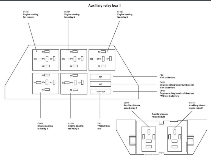

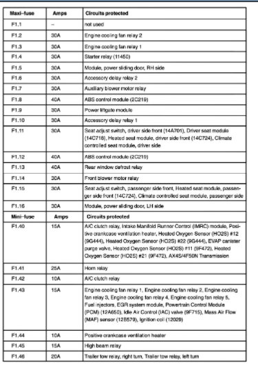

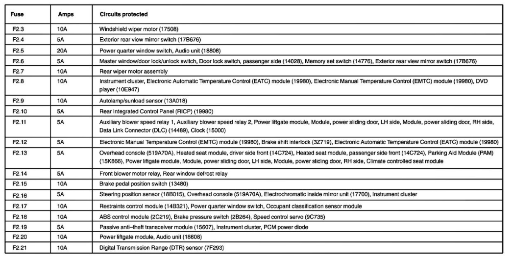

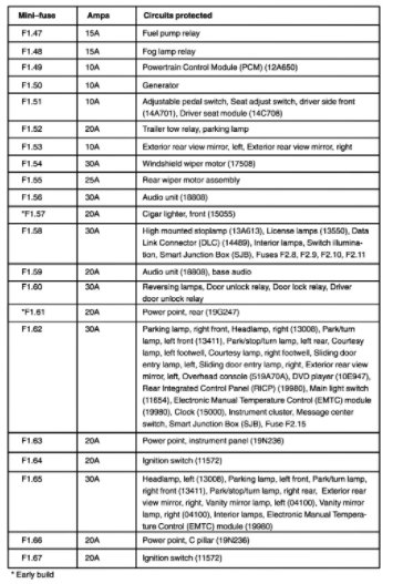

We just replaced our air filter before making our highway trip. Upon returning home we noticed that our lights are not working where are the fuses and how do I check them?

Here is the information you requested. Here are a few tutorials for you to view on how to check and replace fuses:
I've attached pictures below showing the fuse and relay locations on your vehicle. Hope this helps and thanks for using 2CarPros.
