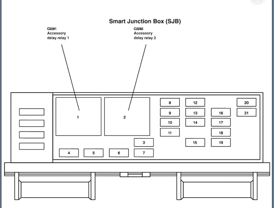

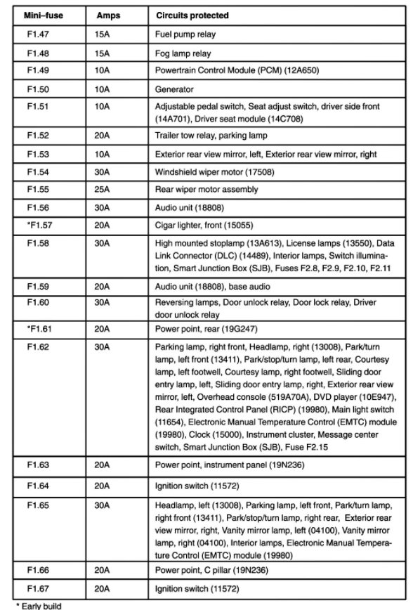

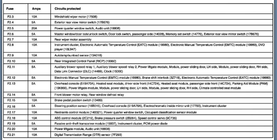

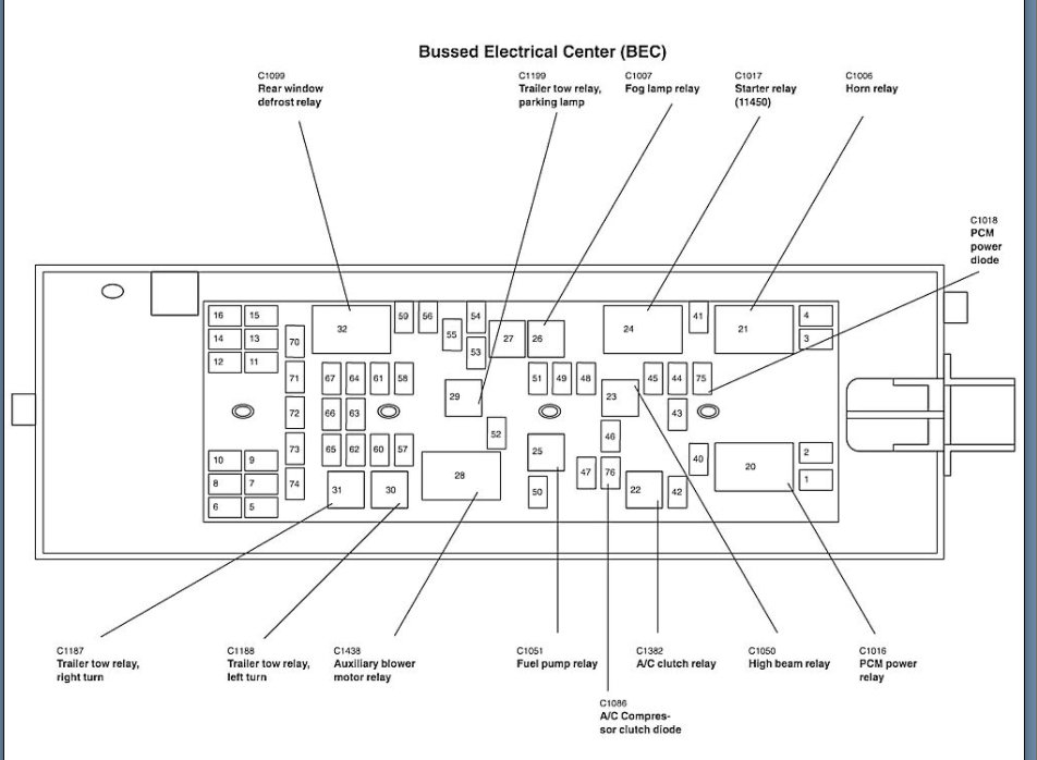

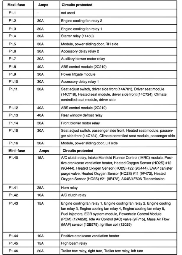

i replaced the bulbs but the lights dont work can you help me check the fuses please?

Sure. Here are some guides that will help with the testing of these fuses and relays:
Please see the attached info below for the fuses. Please run through this detail and let us know what you find. Thanks
