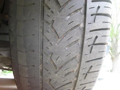

When I go over speed bumps, other bumps like on a side road, the squeak sounds to be coming from the front end.
I am also experiencing uneven tirewear where the inside of the front tires is wearing much quicker than the outside.
What could be the cause of the noise and is it likely to be a cause or result of the improper alignment?

Sounds like worn struts. The noise is common to struts and worn struts can effect wheel canber thus wearing inside of tire.
Have struts ever been replaced?

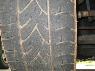

I'm not sure that they have been replaced but I assume not. I am waiting to hear back from the former owners (had this car about a year bought it with about 80,000 on it.
I attached images of the left front:
https://www.2carpros.com/forum/automotive_pictures/158606_lftire_1.jpg
and right front:
https://www.2carpros.com/forum/automotive_pictures/158606_rftire_1.jpg
tires respectively (i hope)
Is there a way i can check the strut myself?

Check strut with bounce test push down on front fender should have lots of resistence. Bounce 4-5 times stop car should stop imediately.
Tires have definate camber wear pattern. Other source of noise ball joints or lower control arm bushings.
Take to a Goodyear tire center have it checked out.
Let me know what they suggest and will advise
