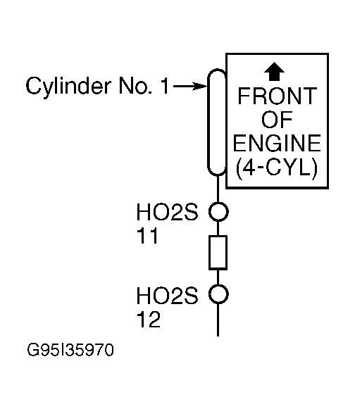

NOSPAMMER
hello,
my 2003 focus lx 2.0L L4 SOHC ~18,000 miles has had the engine light so i went to autozone to read the code.
Autozone obd2 printout says "P2195 lack of heated oxygen sensor- Bank 1 Sensor 1 HO2S11 switch- sensor indicates lean"
they said "Your car is burning more fuel. It's a common problem. It's usually the 1st sensor to go out. It's possibe to DIY. It looks like a spark plug in the exhaust pipe b4 the catalytic converter by exhaust manifold."
I checked with Herko Automotive Group and they said "For your car 2003 FORD FOCUS 2.0L L4 SOHC in the position sensor 1 (Upstream) you need the oxygen sensor number SG1813."
1. i think i see whee the bank 1 sensor 1 in front of the engine but can someone post a pic highlighting the location
2. how reliable is this advice from autozone & herko? should i just replace the sensor or what's the next likeliest fix for this ?
May 20, 2020 at 5:52 AM (Merged)
OBXAUTOMEDIC
  • 3,713 POSTS
Ok, there are a few things that can cause the code you are getting....
40) For Continuous Memory Only DTCs P1130, P1150, & For KOER & Continuous Memory DTCs P1131, P1132, P1151, P1152, P2195, P2196, P2197 Or P2198: Upstream HO2S Not SwitchingContinuous Memory DTCs P1130 and P1150 indicate when an HO2S fails to switch due to a circuit or fuel at or exceeding a calibrated limit. KOER and Continuous Memory DTCs P1131, P1132, P1151, P1152, P2195, P2196, P2197 and P2198 indicate a concern when fuel control system does not detect HO2S switching for a calibrated time. DTCs P1130, P1131, P1132, P2195 and P2196 refer to HO2S-11. DTCs P1150, P1151, P1152, P2197 and P2198 refer to HO2S-21. Possible causes for these faults are:
Fuel System - Excessive fuel pressure, leaking or contaminated fuel injectors, leaking fuel pressure regulator, low fuel pressure or engine running out of fuel or vapory recovery system fault.
Induction System - Air leaks after MAF sensor, vacuum leaks, PCV system or improperly seated engine oil dipstick.
EGR System - Leaking gasket, stuck EGR valve or leaking diaphragm or EVR.
Engine Mechanical - Engine oil overfilled, cam timing, cylinder compression or exhaust leaks before or near HO2S.
Also, I would check for a burnt fuse, since the O2 Sensor is Heated it requires a fuse.
As far as the Advise from AutoZone - they are only reading what the Code Def is and not what other conditions can cause the code and they would love to sell you an O2 Sensor that you may or may not need.
As for the Herko Automotive Group I honestly haven't heard of them, so cannot say.
Image below

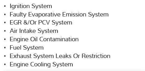

HMAC300
  • 48,601 POSTS
Ignition System
Faulty Evaporative Emission System
EGR &/Or PCV System
Air Intake System
Engine Oil Contamination
Fuel System
Exhaust System Leaks Or Restriction
Engine Cooling System
check all that first including checking air intake for holes and check O2 sensor for a broken wire.

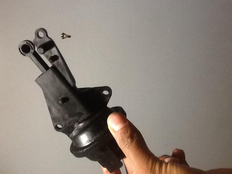

TAYTHEKING
  • 14 POSTS

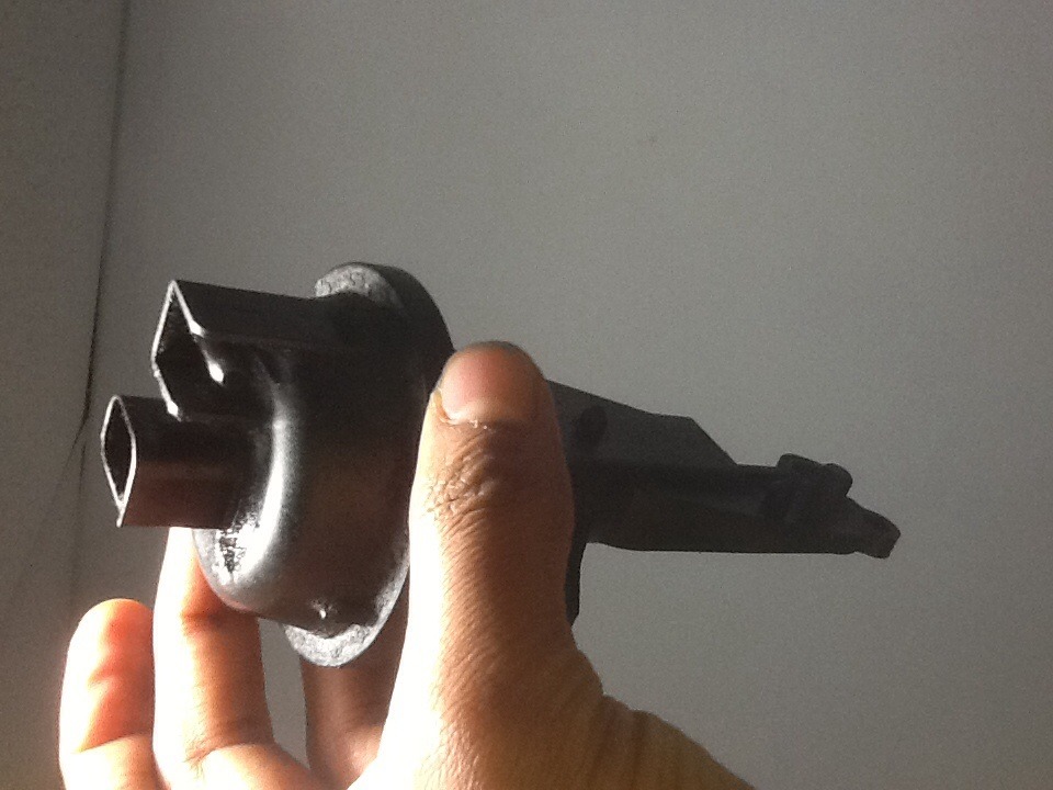

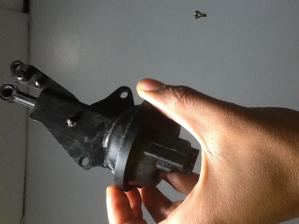

Went to the dealership, was told that it was the imrc actuator, I took apart what I believed is the vac actuator, I wanted to know if this is the correct piece. I also wanted to know if there is a small test I can preform on the actuator while it's out the car to see if it is indeed the correct piece.
More information: I have two imrc solenoid on top of the intake. And followed the one of the right to get the the actuator that I pulled out. I assumed that this is the bank 1, the bank that is giving me the code p2004. Did I pull out the right one for bank 1 or is it the other "actuator" that is connected to the solenoid on the right side that is giving me the cel. I'll include pictures.
If I was indeed right the whole time can someone direct me to where I can buy a new actuator.

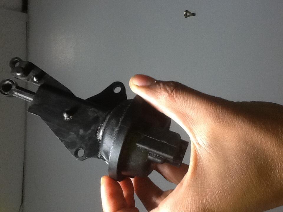

TAYTHEKING
  • 14 POSTS
Here is what I think is the actuator.

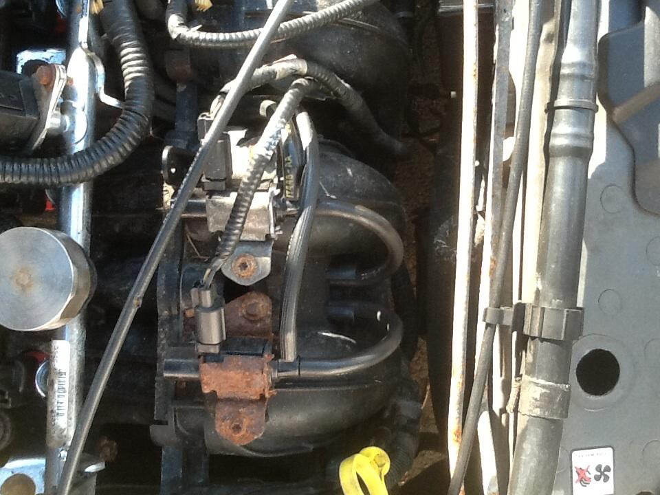

TAYTHEKING
  • 14 POSTS
The two solenoids on the top of intake, the one of the right was connected to the piece it took out

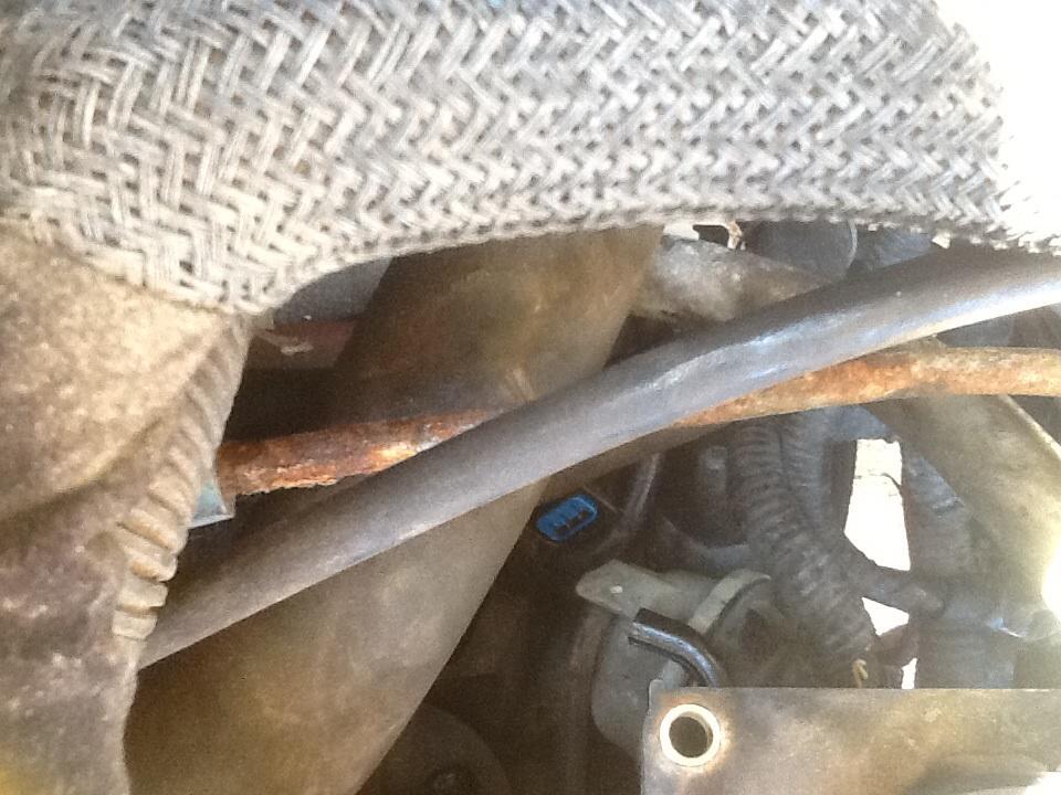

TAYTHEKING
  • 14 POSTS
Alil hard to see but that's the spot where I took the piece from you can see the vac line there. What looks like the other solenoid is connected too is that grayish piece in the middle (the second actuator?)
WRENCHTECH
  • 20,760 POSTS
Why are you so confident that component is the cause of the code? There are 22 pages of tests to resolve that code.

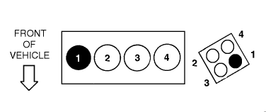

check engine light on -diagnostic test say #2 cylinder misfire and oxygen sensor bad where is #2 cylinder and how do i repair problem

Hi amckey,Welcome to 2carpros and Ty for the donation. Start by checking the spark plug,compression and fuel injector on #2 cylinder.
https://images.2carpros.com/forum/automotive_pictures/12900_fo_14.gif

The mechanic told me it was under the throttle body, on the right side of the intake, which vac lines in it. So that's where I looked and found. I also followed the right solenoid to get to that piece. So I'm like 80% sure. That's why I'm here...for the other 20%.
TAYTHEKING
  • 14 POSTS
The mechanics, told me it was actuator. As they checked out my car for the day.
WRENCHTECH
  • 20,760 POSTS
You can't assume that is the problem. There are a dozen other reasons that code could set.
TAYTHEKING
  • 14 POSTS
The mechanics told me it was the actuator and they had a hard time looking for the part so they let me have my car back till they can find and buy the part somewhere. So I now have the opportunity to fix the problem myself after getting the free check up. Can you answer my question please.
WRENCHTECH
  • 20,760 POSTS
Being that it's an inline 4 cylinder car, I have nothing to identify bank 1 from bank 2 since it only has one bank. You can test the actuators with a hand vacuum pump to determine if they are working properly. As far as purchasing one, the dealer is the one and only place that I believe sells this.
