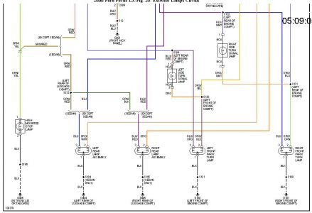

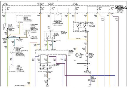

Checked the flasher fuse and it is good. However the emergency flasher switch wont turn on and the blinkers dont work. Brake lights wont turn on either.
What can the problem be. Where should i start?

The one component that ties into all of the is the hazard flasher switch. That is where I would focus on.
https://images.2carpros.com/forum/automotive_pictures/30961_foc1_1.jpg
https://images.2carpros.com/forum/automotive_pictures/30961_focu2_1.jpg
