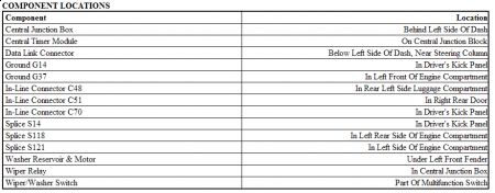

My windscreen washers have stopped working after the cold weather,I tried to use them when they were frozen,could this be the problem? I have pressed them(front and Back) but there is no noise from the motor under the n/s front wing(I think this is where it is)?? Is there a fuse for them?If not,what can I try next? thank you.

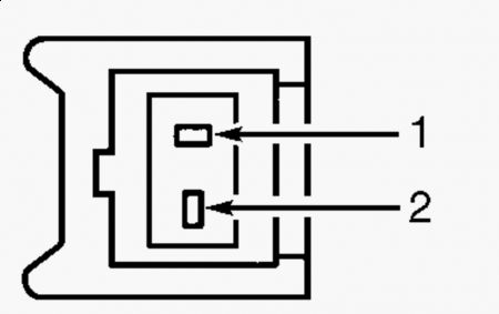

TEST D: FRONT WIPER WASH & WIPE FUNCTION INOPERATIVE OR DOES NOT OPERATE CORRECTLY 1. Turn ignition switch to RUN position. Operate multifunction switch to wash and wipe function and check for proper operation. If wipers and washers work properly, go to next step. If wipers and washers do not work properly, go to step 5 . 2. Turn ignition switch to LOCK position. Disconnect washer pump harness connector C828. See Fig. 6 . Turn ignition switch to RUN position. Turn multifunction switch to wash and wipe function and measure voltage between terminal No. 1 (White/Black wire) and terminal No. 2 (Yellow/Black wire) at washer pump harness connector C828. If battery voltage exists, replace washer pump and retest. See WINDSHIELD WASHER PUMP & RESERVOIR under REMOVAL & INSTALLATION. If battery voltage does not exist, go to next step.

Thanks for your reply but I do not understand a word of it sorry, do you know if there is a dedicated fuse for the washers I have checked 43 and 55 and they are fine but i cannot see any others in the manual??

You will have to pull the plug off the pump, push the tab down then pull connector off, after it's off, you need a voltmeter or test light, with a volt meter put 1 lead in each cavity of the connector, and activate the washer, if there is voltage, replace the pum...this is not an uncommon part to need replacing, and they arent too expensive.

No thats more like it, I understand that and will try it, Thanks again I will let you know the outcome.

FIXED!!!!!! yes it was the washer pump, yes I did it myself....£10 from the scrap yard, so thanks to everyone who helped and offered advice, Pheww clean windows!!!!!
