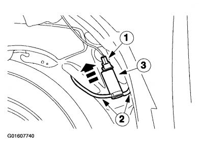

Windscreen washers not working(not frozen) blew down pipes (got bubbles) Washer motor working,will not deliver water.

use a voltmeter to check you are getting power to the pump when someone presses button .. if no power check wiring and fuse ... if getting power replace pump
