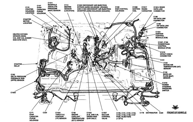

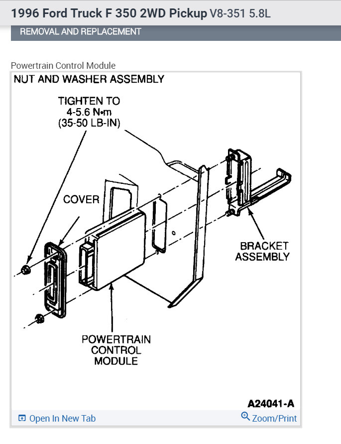

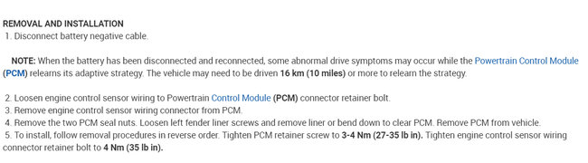

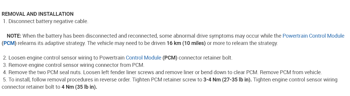

Where is the ECM located?
Jul 27, 2009 at 3:10 AM
KHLOW2008
  • 41,814 POSTS
Hi PrettyPrincess,
The ECM is known as the PCM in diagram and is located on left side of firewall, left of main wire harness connector. Check out the diagrams (Below). Please let us know if you need anything else to get the problem fixed.
