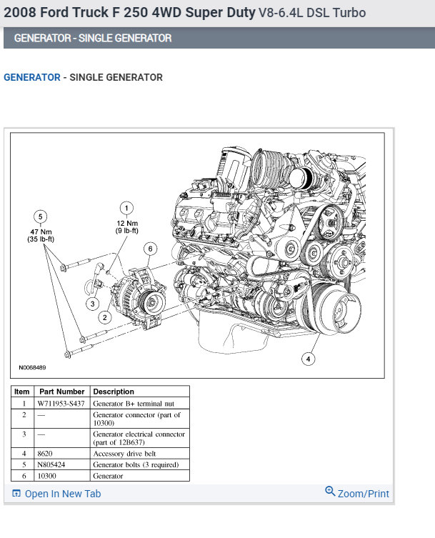

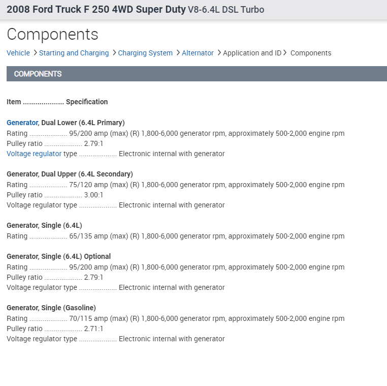

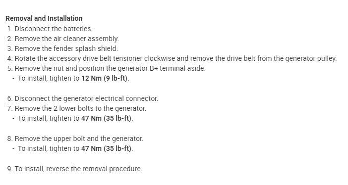

The charging system warning gets triggered when the alternator is unable to charge the battery. This will effectively discharge the battery as you drive the vehicle.
It could be due to a bad wiring to the battery, or it can be a bad alternator.
Keep in mind that the battery can have just enough charge to turn on the radio, dash light etc., but not enough power to start the engine.
Have you tried to jump start it?
https://www.2carpros.com/articles/how-to-jump-start-car-battery-using-jumper-cables
Typically, with a bad alternator, the engine will start but then it will stall after the jumper cable gets disconnected.
