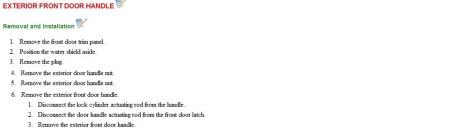

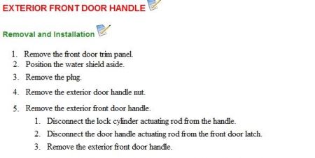

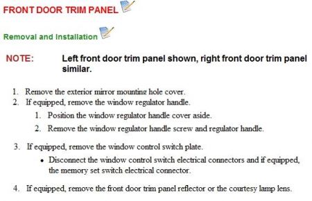

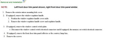

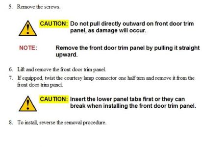

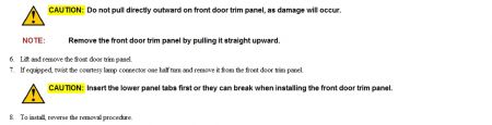

I am trying to put chrome covers on my 2005 F250. But the handle cover is to close to the door to allow the stick on covers to pass by. Is there a way to move the handle? And how do I get the door panel off?

Mar 10, 2010 at 1:21 PM
BOB1047
I am sure the your response is what I need but it is to small to read. Need it to be bigger. I have tried copy/ paste, highliting it and nothing worked to get it bigger
Mar 11, 2010 at 5:04 AM
BLUELIGHTNIN6
  • 16,542 POSTS
Sorry about that, what is your email address and I will email it to you. Will be able to enlarge it then.
Mar 11, 2010 at 5:08 AM
BOB1047
Bob1047@msn.com
Mar 11, 2010 at 5:12 AM
BLUELIGHTNIN6
  • 16,542 POSTS
thanks i have emailed the diagrams to you and also i edited them and reposted them below, hope that helps..
