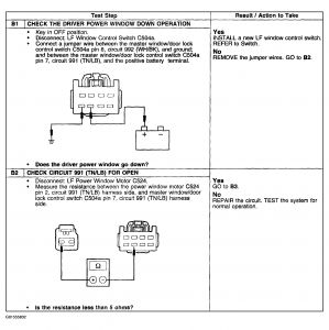

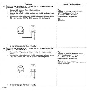

driver window will not roll up.window did roll down fine.all other windows work up and down ok.can you guide me in the right direction to troubleshoot this problem and repair it? thank you, bob k.
