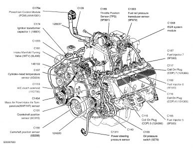

recently my truck has a miss in it every time i cruise at about 2000 RPM then step on the gas it will start to spew black smoke and miss. when i let off the gas it will stop and return driving as normal .it also does it when driving over an overpass or up a hill

Sounds like either a restricted air filter or MAF sensor.
https://images.2carpros.com/forum/automotive_pictures/62217_ford_1.jpg
On drivers side front for 4.6 on top for 5.4
