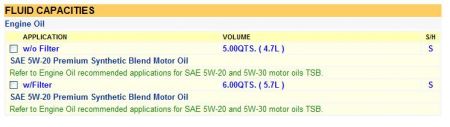

What is the proper amount of oil in a 1998 4.6 L engine with filter change ? My Ford book calls for 6 QTS. I have a warranty that requires an ASE mechanic to do the oil change. The invoice says they put in 5 QTS. Did the mechanic. mess-up ???

Looks like 6 quarts (5.7 litres) with the filter for your engine size.
https://images.2carpros.com/forum/automotive_pictures/261618_Noname_4.jpg
