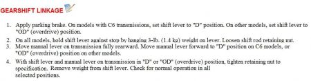

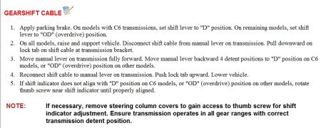

This truck has an automatic trans and when you put in gear it doesn't line up with the D or the 2 and it will go into both Drive and 2nd but It won't go into 1st all the time it keep it feels like it not push it in far enought I got under the truck and looked at the trans and it has a cable that goes to it but its not lose or anything but the shifter feels funny is their an adjustment in the steering column or anything like that?
