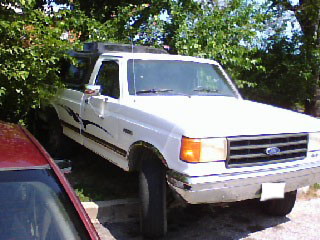

hey as always bro you have been the greatest you have saved me tons of money. this truck seems to have it's smallest probs so far but lol i don't want to jinx myself for any other problems but yea i now know when i ask you whats wrong with my truck i know to not ask ?s just to buy the part and put it on and have no worries. bro you have been the coolest in my book. thank you and thank you a million. this is the truck i been asking so many ?s about lol. man that engine sounds so good in it it has the inline 6 4.9 4 speed man shift this truck realy came a long way i only payed $500 for it $300 install clutch, clutch plate, throwout bering, $146 in parts, clutch master- slave cylinder, ran me about $125. so far i feel like it's been a good deal.
https://images.2carpros.com/forum/automotive_pictures/190787_0702081532_1.jpg
