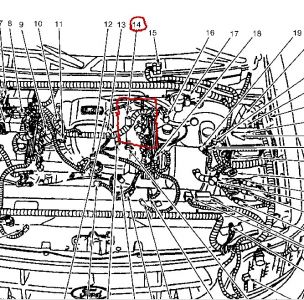

Ok, thanks. Where is the DPFE Sensor located?
Monday, January 29th, 2007 AT 8:28 AM
SERVICE WRITER
  • 9,123 POSTS
https://www.2carpros.com/forum/automotive_pictures/30961_dpfe_1.jpg
https://www.2carpros.com/forum/automotive_pictures/30961_dpfe2_1.jpg
Link with some insights:
http://www.focushacks.com/index.php?modid=80
Monday, January 29th, 2007 AT 6:08 PM
NEW1
  • 5 POSTS
Wow! That is an awesome illustration and so is the attached website. Thank you so much. I am also so glad I found this forum, it's great to have this information available to consumers. I know we will never replace our mechanics it will give us an edge so we won't be taken for a ride. Thanks once again.
