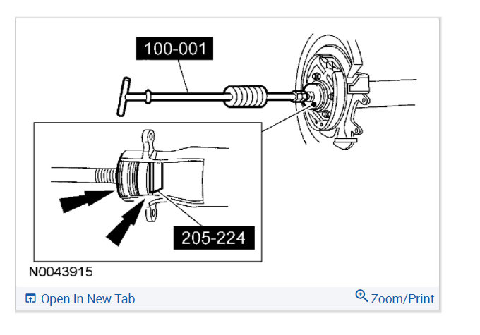

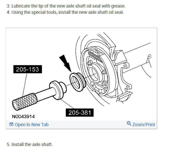

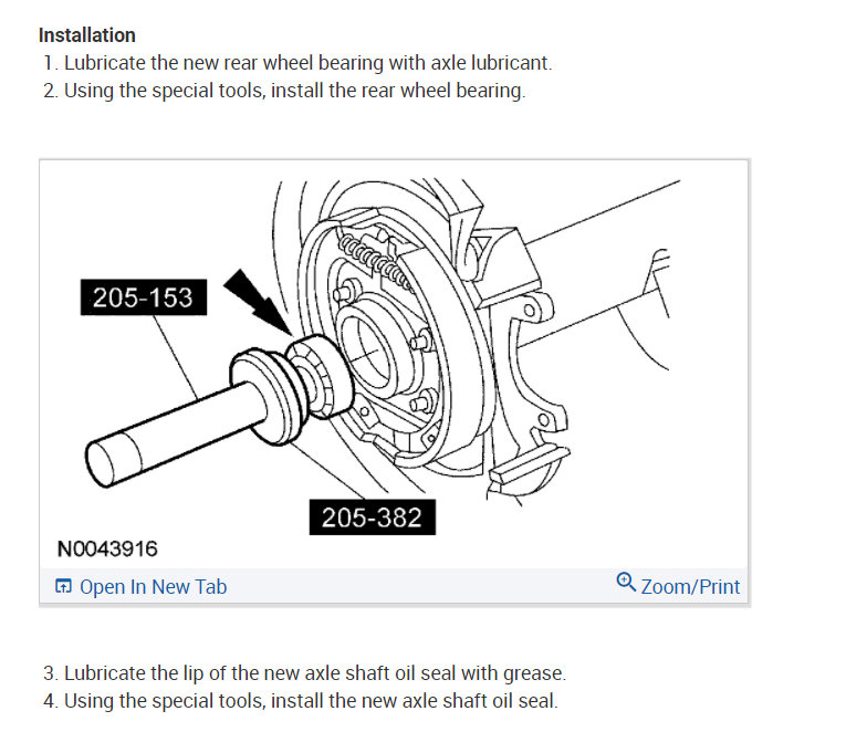

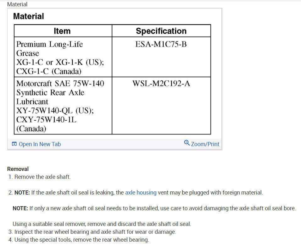

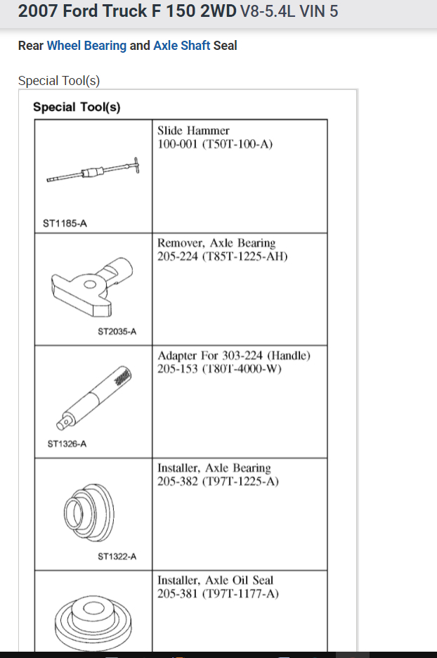

I am already have problems replacing the axle seal can you help? Thanks.
Wednesday, September 16th, 2009 AT 9:15 AM
KEN L
MASTER CERTIFIED MECHANIC
48,356 POSTS
This video shows the job being done on a similar car but the process is the same.
https://youtu.be/ytqXLSjHNm0
Here is a guide to help you step by step with instructions in the diagrams below to show you how on your car.
https://www.2carpros.com/articles/rear-axle-seal-replacement
