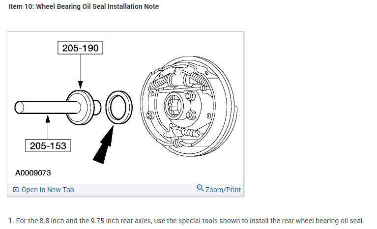

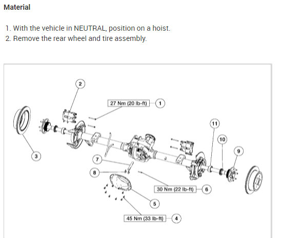

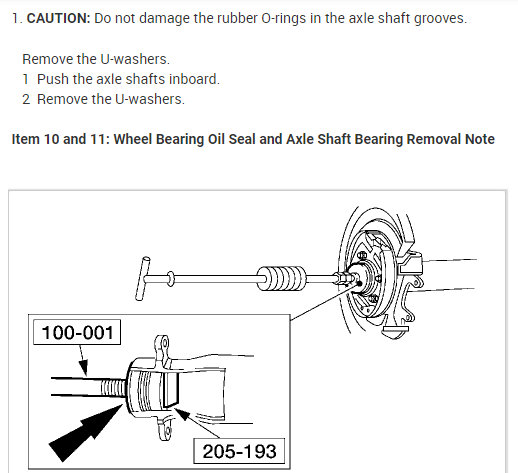

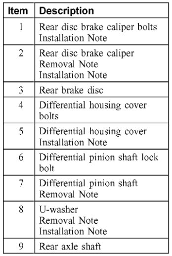

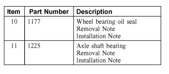

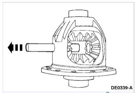

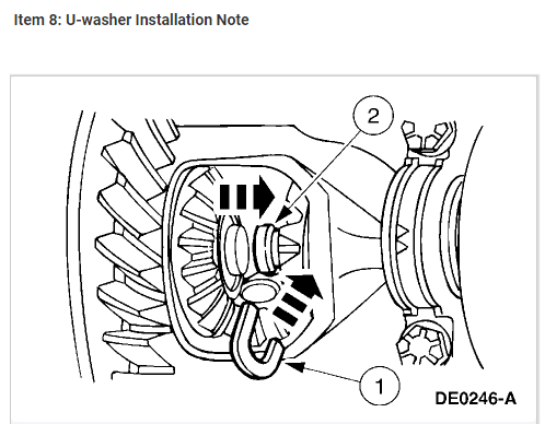

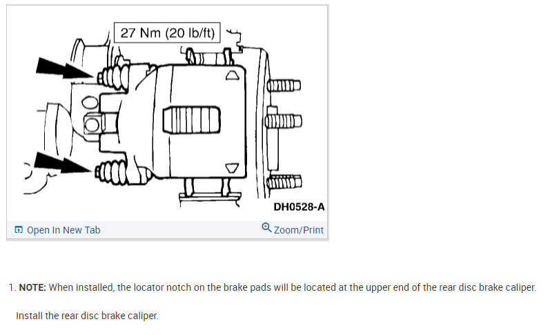

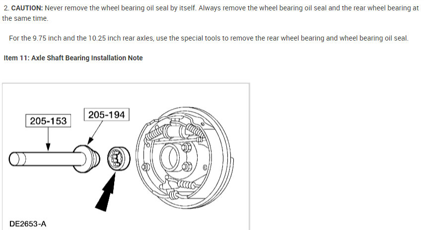

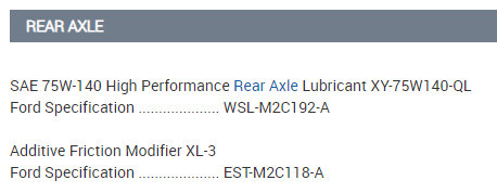

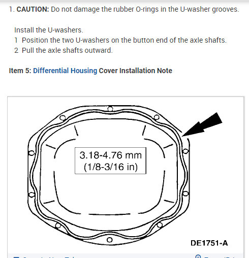

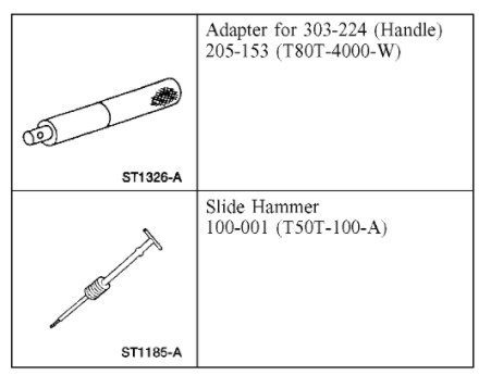

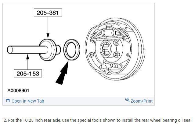

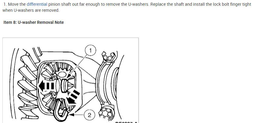

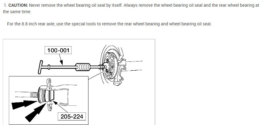

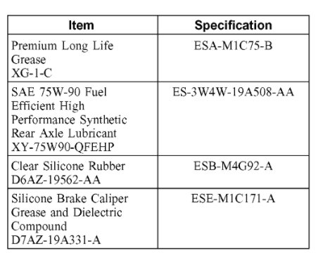

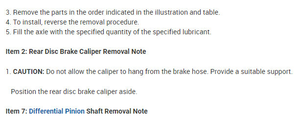

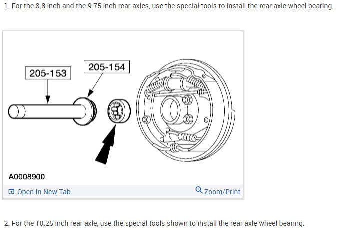

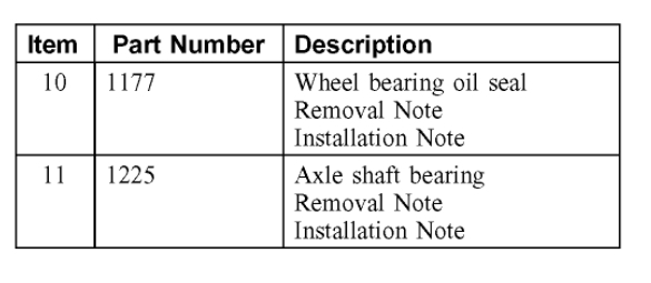

Hi, I'm looking for instructions on how to replace a rear axle seal on my 2004 4x4 f150. It has 125,000 kms on my 5.7 litre. It also has disc brakes.
Jun 11, 2007 at 3:26 PM
DANNY L
  • 5,648 POSTS
Hello, I'm Danny.

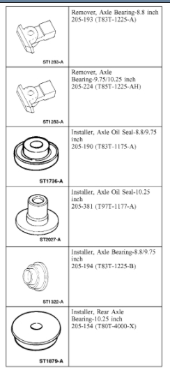

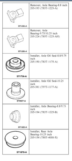

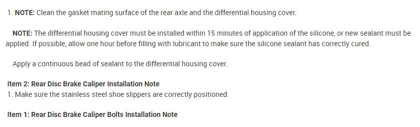

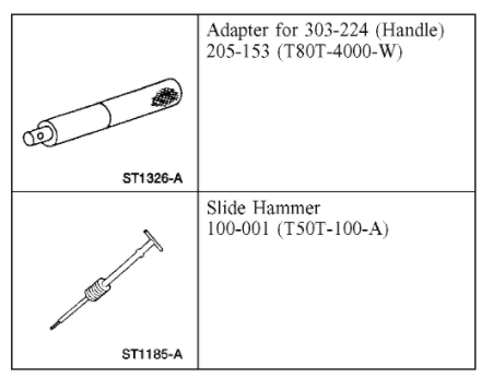

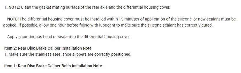

Here is the information you requested. Here is a tutorial showing how to change the rear axle seals on your truck:
https://www.2carpros.com/articles/rear-axle-seal-replacement
https://www.2carpros.com/articles/differential-service
I've attached picture steps below on how to remove and replace the axle seals on your truck. The other tutorial shows how to add gear oil back into your differential once the repair is complete. The last picture I attached below shows the type of rear differential gear oil specification .Hope this helps and thanks for using 2CarPros.
