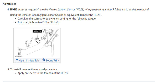

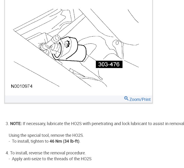

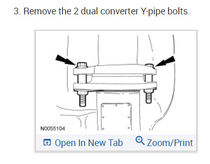

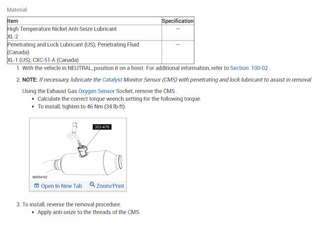

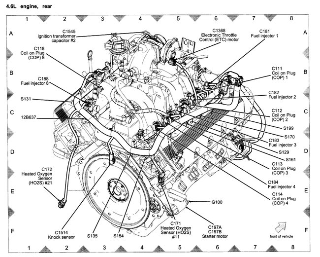

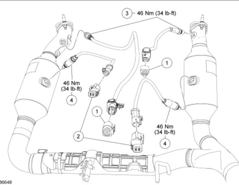

The O2 sensor can be read using live data feed, if it is not working with in the required voltage it should be replaced. failed o2 sensors will increase fuel economy. Here is how you can change the sensors and their location as well in the diagrams below but check out this guide first
https://www.2carpros.com/articles/how-to-replace-an-oxygen-sensor
and
https://www.2carpros.com/articles/how-to-test-an-oxygen-sensor-02-sensor
Please run down these guides and report back. The secondary sensors are thein the catalytic converters. Check out the diagrams (Below). Please let us know what happens.

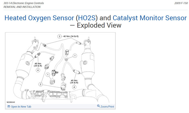

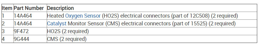

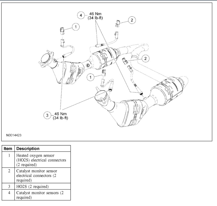

Hello, I'm Danny.
It's showing four sensors in total. Two are pre-catalytic converter and the other two are mounted in the converters. I've attached a picture below. Here is a tutorial showing how to replace Ho2 sensors:
https://www.2carpros.com/articles/how-an-oxygen-sensor-works
Hope this helps and thanks for using 2CarPros.

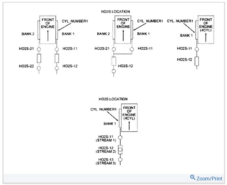

Where is the location of the heated oxygen sensor Bank 1 Sensor 1. Is it on the drivers or passenger side of my 2006 F150 5.4l v8?
Thursday, September 10th, 2020 AT 6:07 PM (Merged)
  • 75,992 POSTS

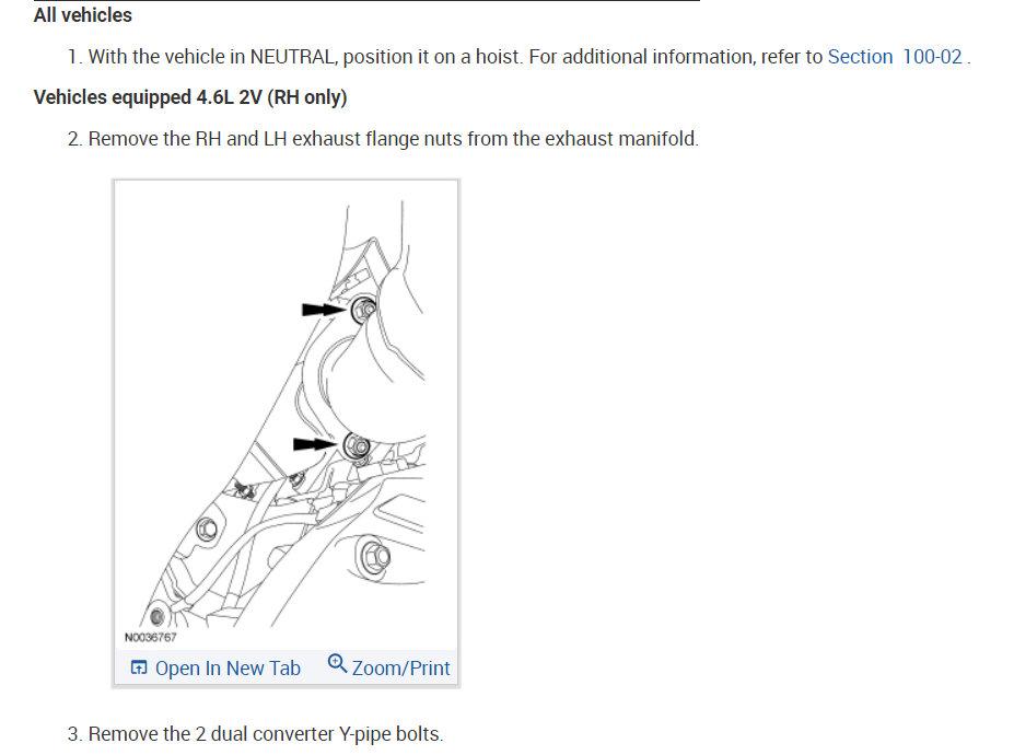

Here is a guide to help you see what you are in for when changing the sensors out and the location of the sensors in your truck below.
