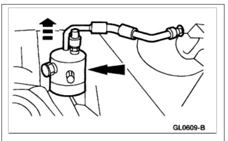

Can you send me a picture of the air conditioning system that would show me where the low pressure port is located so I can hook up a recharge kit.
Apr 20, 2021 at 2:31 AM (Merged)
RACEFAN966
  • 5,029 POSTS
It is on the top of the reciever dryer. Here is a pic of it and the low pressure port is on top near the hose that comes out of the top. Hope this helps. Your donations is what keeps us going. Thanks.
https://images.2carpros.com/forum/automotive_pictures/249564_174817_1.jpg

GLEWBA
I purchased an AC recharge kit but cannot find the port to add the refrigerant to. Can you help me locate the port?
Apr 20, 2021 at 2:32 AM (Merged)
KLSHIEL
  • 163 POSTS
Here is a guide that shows you how to recharge the system and the port location below on the side of the accumulator:
https://www.2carpros.com/articles/air-conditioner-how-to-add-freon
Cheers
