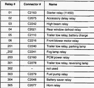

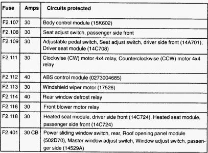

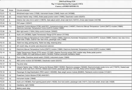

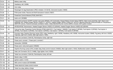

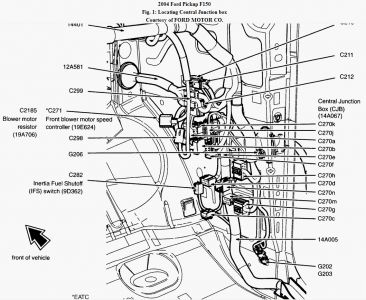

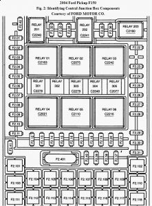

my entire A/C unit including the heat seaters is not getting power. none of the lights or fan nothing will turn on when i try i dont have an owners manuel so i dont know which fuse it could be or what. could you please help thank you
Jan 21, 2010 at 3:38 PM
MERLIN2021
  • 17,250 POSTS
Heat seater? Do you mean the heated seats dont heat? And the heater doesnt work? No power to the panel? Is it auto temp or manual heat/a/c? Look at this diagram of your fuse box, EATC(heat/A/C) is fuse #F2.05 7.5 amp F2.13 10 amp, Heated seat module is F2.18 10 amp.
