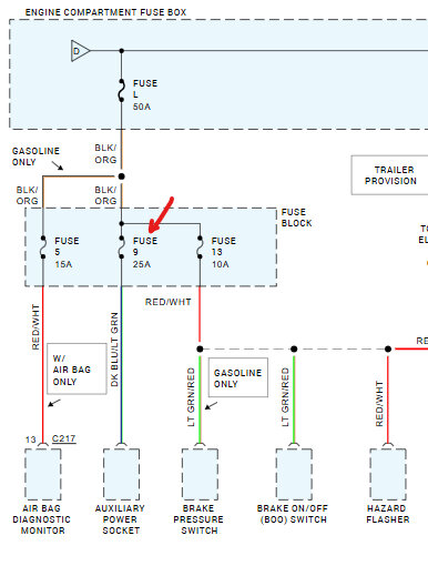

do you have a wiring diagram for power distribution box. a95 should have letters but my cover for the PDB has numbers. fuse 9 keeps blowing when i turn the key to ignition. what does fuse #9 power. thank you

The #9 fuse just does the power point socket, please check out the wiring diagrams below to confirm. Check out the images (below). Please let us know what happens.

I don't think so, this fuse powers the cigarette lighter? Are you sure you have the right fuse #?
