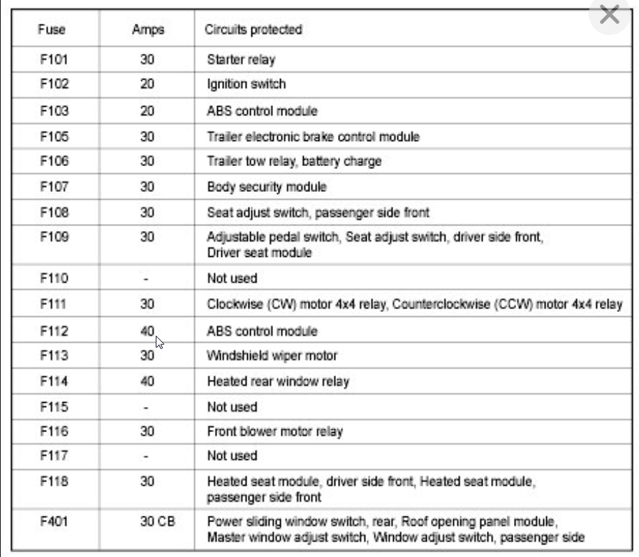

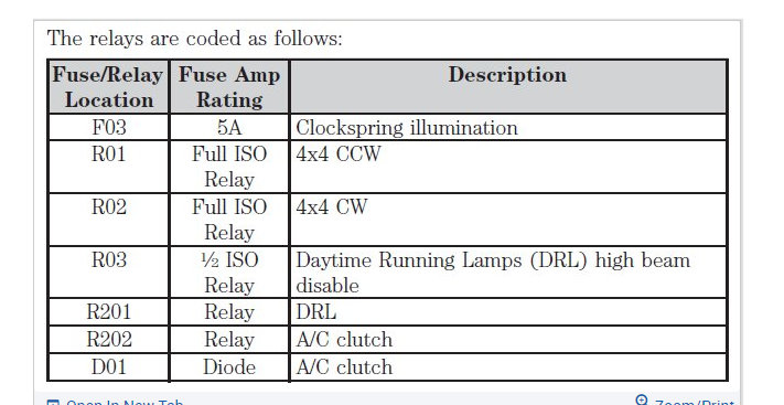

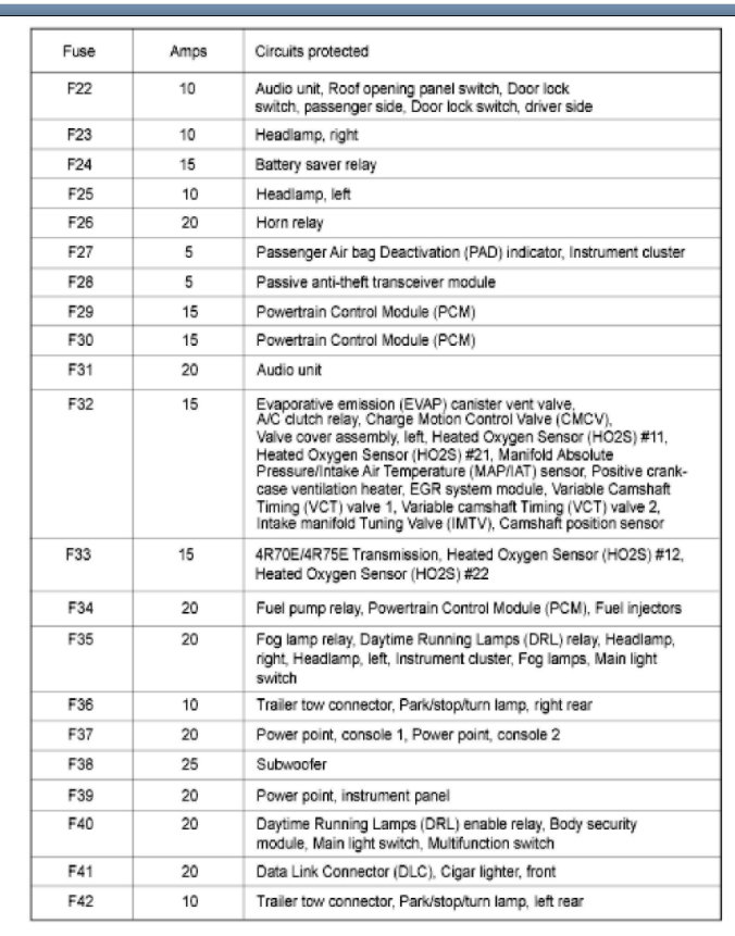

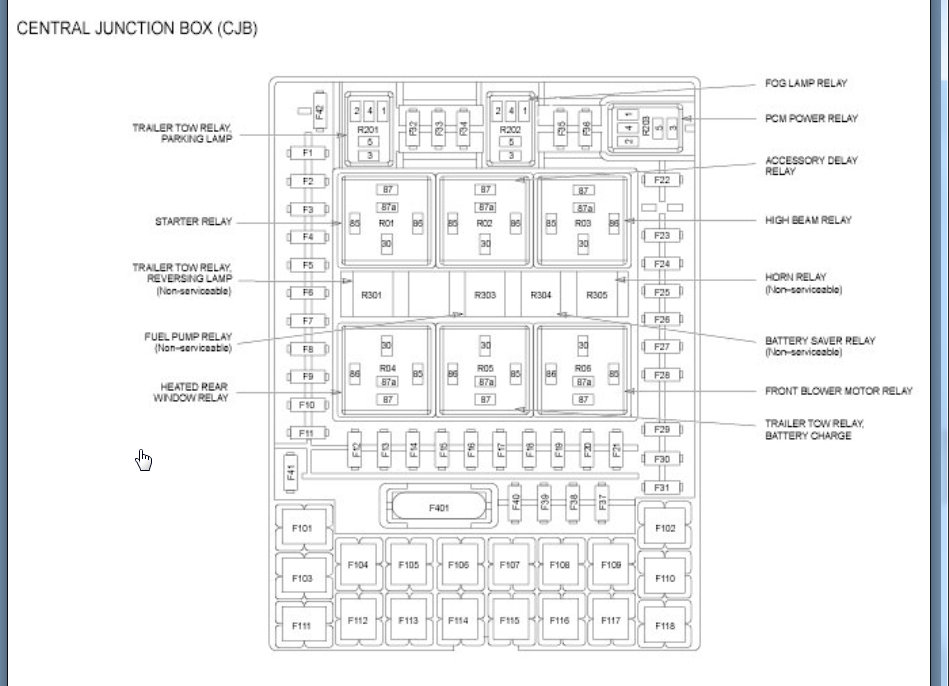

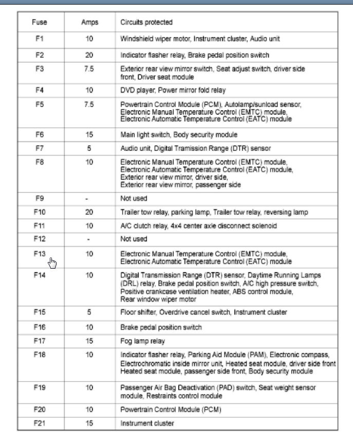

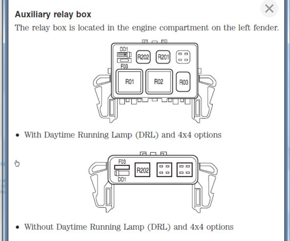

Can you tell me where the fuses are and what they go too?
Oct 6, 2010 at 7:07 PM
I am attaching the info below for the fuse and relay locations. Please run through this and let us know if there is more information.
Plus here is a guide that will help with testing and replacing the fuses:
Thanks
